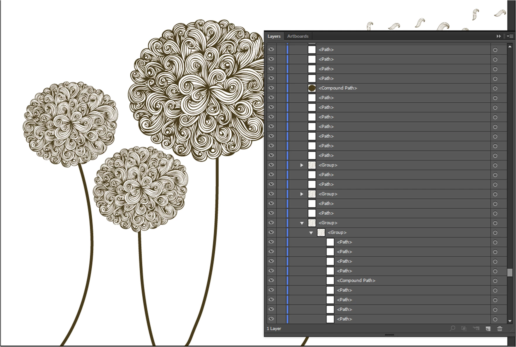

The art must be made up of symbols and therefore you have o enter either isolation mode or use the method Monika mention Edit>Edit Colors> Recolor Art.
Thank you all!
The 'Recolor art' method worked! Yahoooo!
With my knowledge in Ai I will not be able to do anything else with this image but at least I can change the color now!

If this helps, here is a print screan as I cannot uploud real image... This image consists of 1 layer that is divided in thons of paths and some Compound Paths...
Thanks a lot!

Before the PrintSceen, if you click on one of the swirls with the Direct Selection Tool and make sure that swirl is shown on the Layers panel (with a solid dot to the right), and if you also show the bottom of the Toolbox (with Fill/Stroke), and if you also show the Document Info panel (with Objects ticked, not Document), it may help helpers help you.
