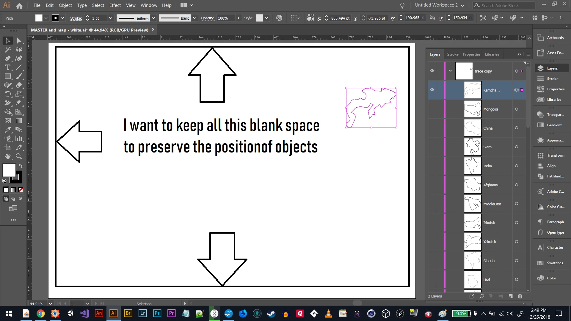

Hi folks,
I have a map of the world with countries on different layers. I need to end up with every country on it's own png file, and I need to keep the position of the object.  (I'm importing the png's to Unity and I don't want to manually place each country). I've figured out how to export the layers as separate png's, but the result is an image cropped to just the country object.
Hopefully the images explain what I'm looking for.
Thank you!

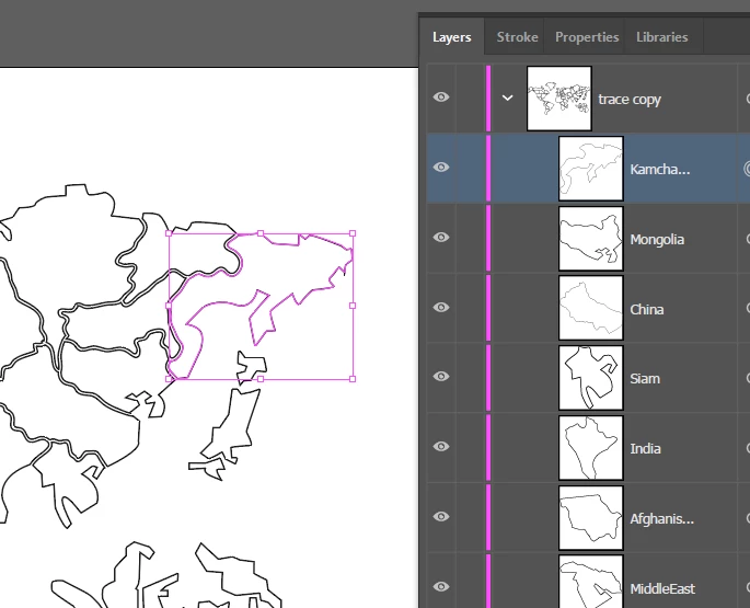

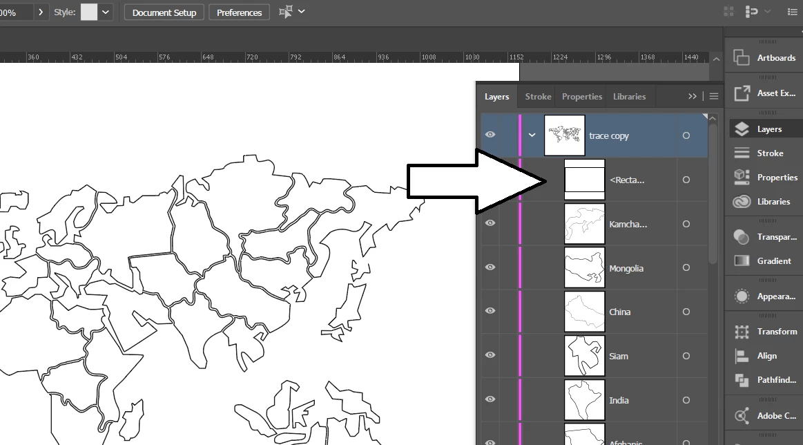

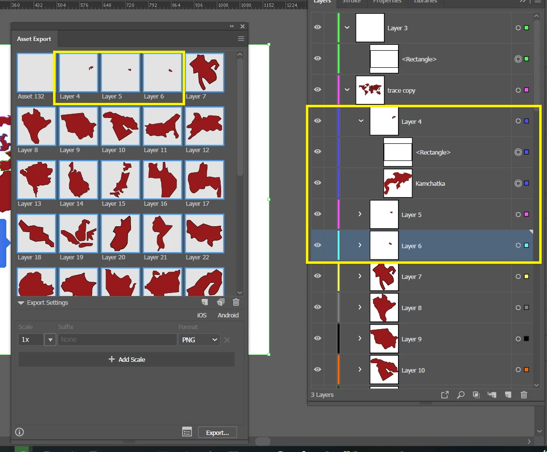

    Hi, yes add a new layer on top of the stack then add the border rectangle in that new layer
    Dec 27, 2018 11:03 PM UTC
    Okay I've tried adding a layer with the rectangle border, but it's not being applied to the other layers. I'm using the Asset Export window, and it looks like this (pic1). Alternatively, I can drag and drop the rectangle onto each layer one at a time, and that works in the Asset Export (pic2). Doing it that way, even though it works, is prone to lots of little mistake as I drag and drop.
    (I've also tried having the countries as objects and also as layers, made by: "Release to layers - sequence" but that doesn't help. It creates a layer, but doesn't grab the name which would be nice.)
