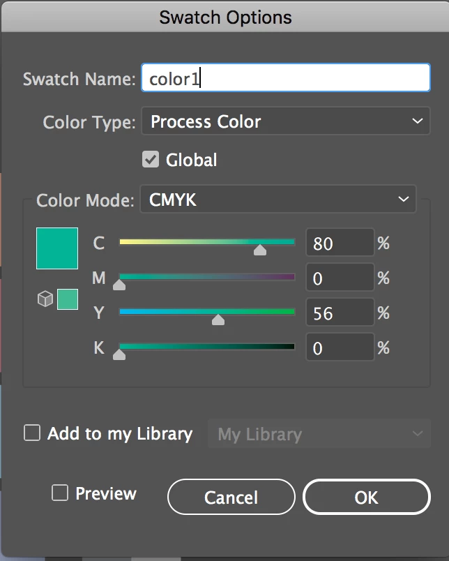

    I double checked the colors and here is the screenshot, I believe they are processed CMYK.

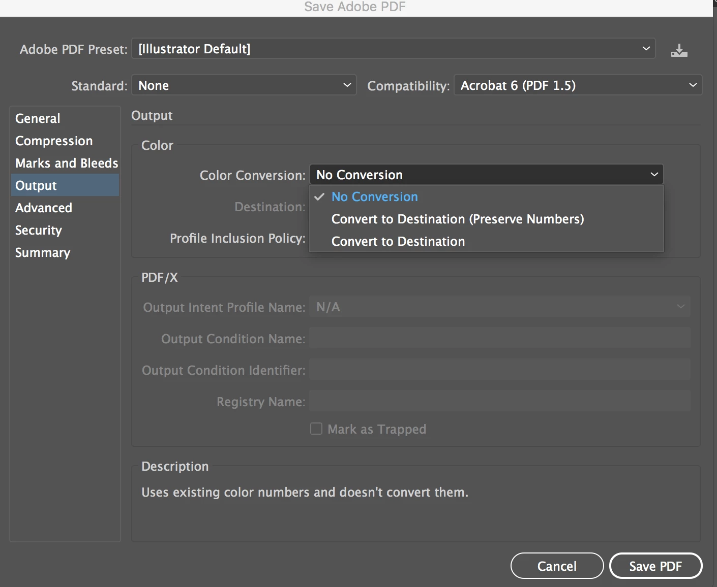

    Also for Color options I tried these settings and tried No conversion
    and this,

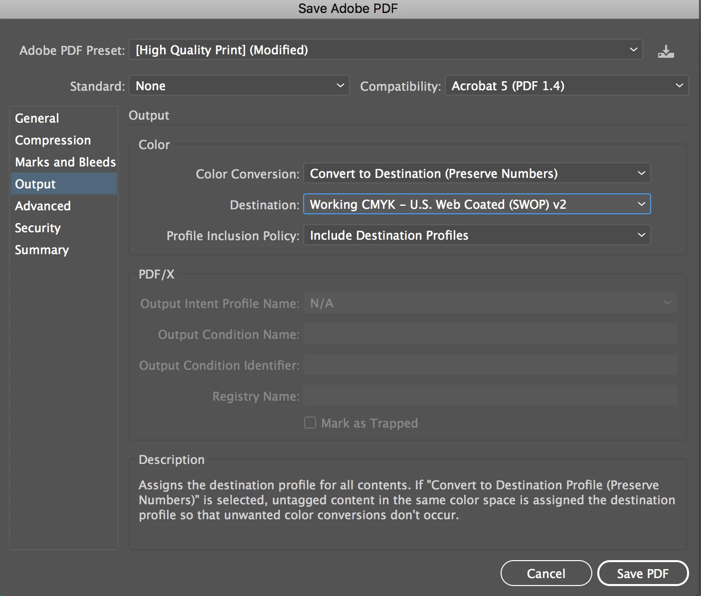

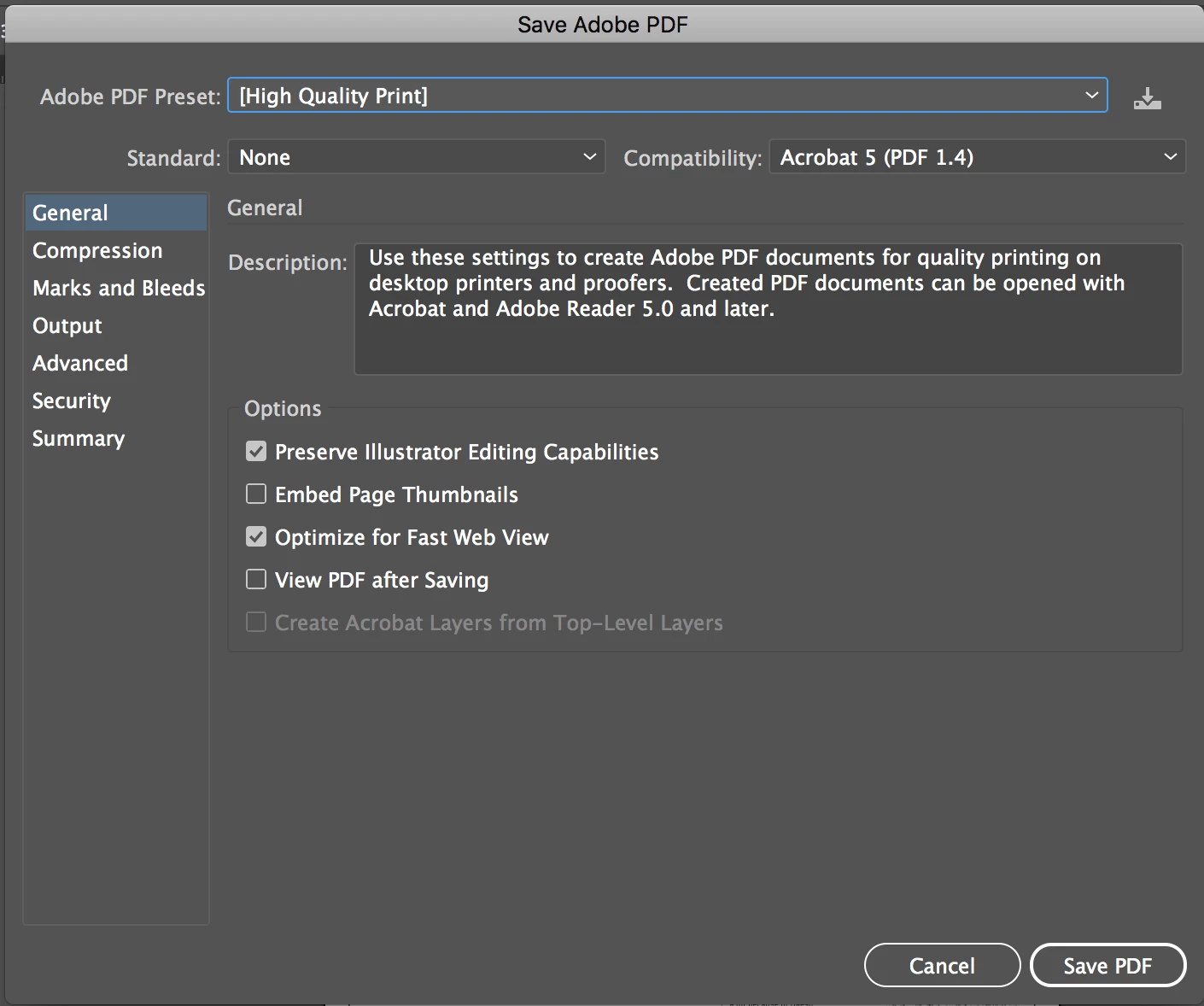

    kaano85189122
    December 20, 2018
    I go save as pdf, then I use these settings (Attached Screenshot)
