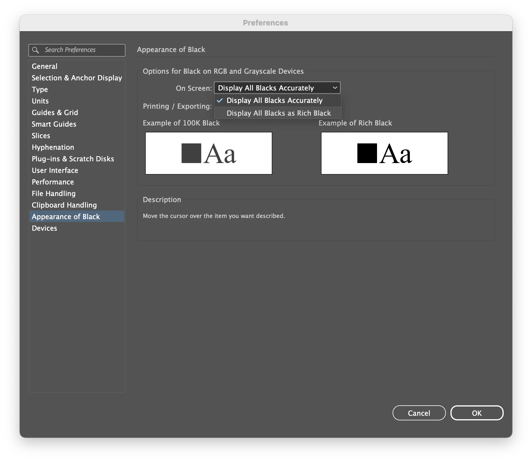

To add to what Monika said, check what is set in the Preferences > Appearance of Black.

I did go ahead and change the Appearance of Black in Preferences but it hasn’t fixed the issue.
My file(s) still default back to a dark grey.
