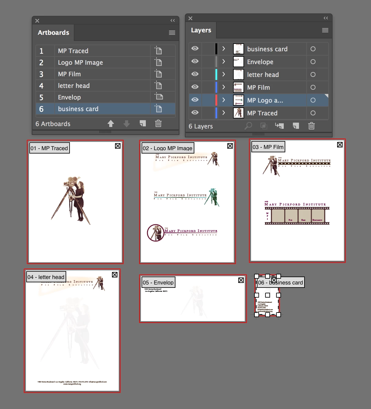

February 8, 2017
Illustrator is different than Pages or spread in Indesign where layers are based on the spread.
You can do it but it is a manual job!
I do it all the time to make sure some of my layers are based on Artboard.
(It is almost like in PS but here you have a choice...)
Here are some screenshots...see the layers and Artbord have same name but I moved it manually
