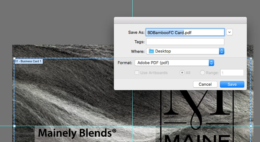

    Apr 17, 2019 11:54 AM UTC
    As you can see in the image above when I tried to Save As or Save a Copy (the same image occurs with no checkbox for use Artboard) the "Use Artboard" option is no longer available. In previous versions of Illustrator all I had to do was choose Save As, select PDF and I could check "Use Artboard" and a PDF file was created of only the content within the Artboard with everything else being ignored.
    When I make business cards for my products I have the images of different products outside of the artboard (usually2 to 3) and I swap the images into the artboard space and adjust the Text description and then choose Save As a PDF with Use the Artboard for the PDF. Now I cannot do this and I have to use the Crop Tool before using Save As a PDF . . . more steps.
    Adobe has broken Illustrator it seems.

    Ton FrederiksCommunity ExpertCorrect answer
    Apr 17, 2019 12:08 PM UTC
    There is only a checkbox for Use Artboards when you have multiple artboards and then it is automatically checked.
    If you want to get rid of items outside the artboard (and these should not touch the artboard), uncheck the "Preserve Illustrator Editing Capabilities" when saving as PDF. Be sure to have a copy of your original Illustrator file.
