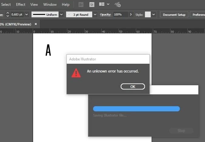

I am getting an unexpected error dialog when I try to save a file in Illustrator 2017. It seems to happen after I add a few layers and use the pen tool. I had to roll back to the previous version and that works fine. Wondering if anybody else has had the same challenge. On a win 10 surface.

    I'm having the same issue, though not with every file, and I can't figure out the common denominator of the files it happens with. The only way to get the file to save once I get the "Unexpected Error" message is to show all layers as well. I hope this is fixed soon.

    I'm having a similar issue. I'll be working on an illustration, and Illustrator quits suddenly. The recovered file comes up when I restart it, but I can't save over the old file, nor rename it as a new file. Keeps giving me the "unexpected error" notification.

    Just found out, it will save, but ONLY if ALL my layers are UNlocked.

    i found the same workaround : all layers must be displayed and unlocked to be able to save the file....

    I'm having the same problem, right after I upgraded to 2017 version.  This must be a bug imo.
    It happens to some of my files. Strangely when the files have locked layers, the files won't save.  But when I unlock all of the layers, the files can be saved successfully.
    November 5, 2016
    It happens to me while my files are in RGB mode, change to CMYK then files could be saved even with locked layer/sublayer.

    Hi Torgeir,
    Were you saving the file locally in the machine? Please share the screenshot of the error.
