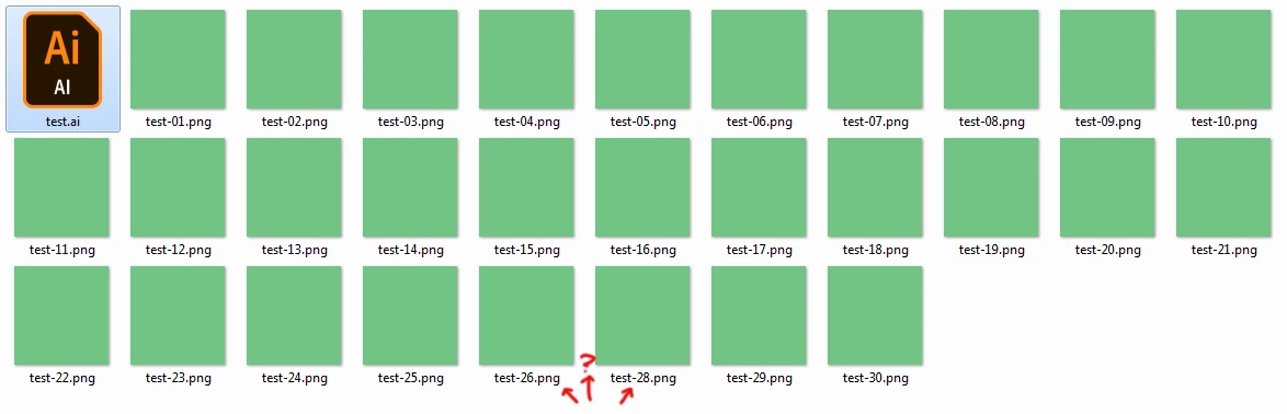

    It has nothing to do with my file. Regardless of content, if I create 30 artboards, Illustrator will not export artboard 27. It also skips 57. I haven't gone higher but I'd be surprised if it stops there. I don't know how to attach a file here so I uploaded one here, it's just a dummy though because the content doesn't matter.
    https://goo.gl/5GqECG
    October 20, 2017

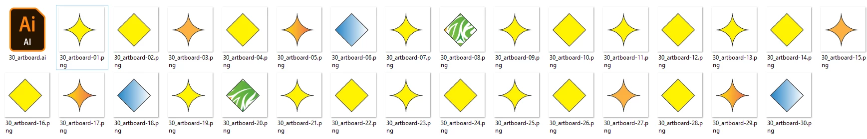

    This might make it clearer for you...
