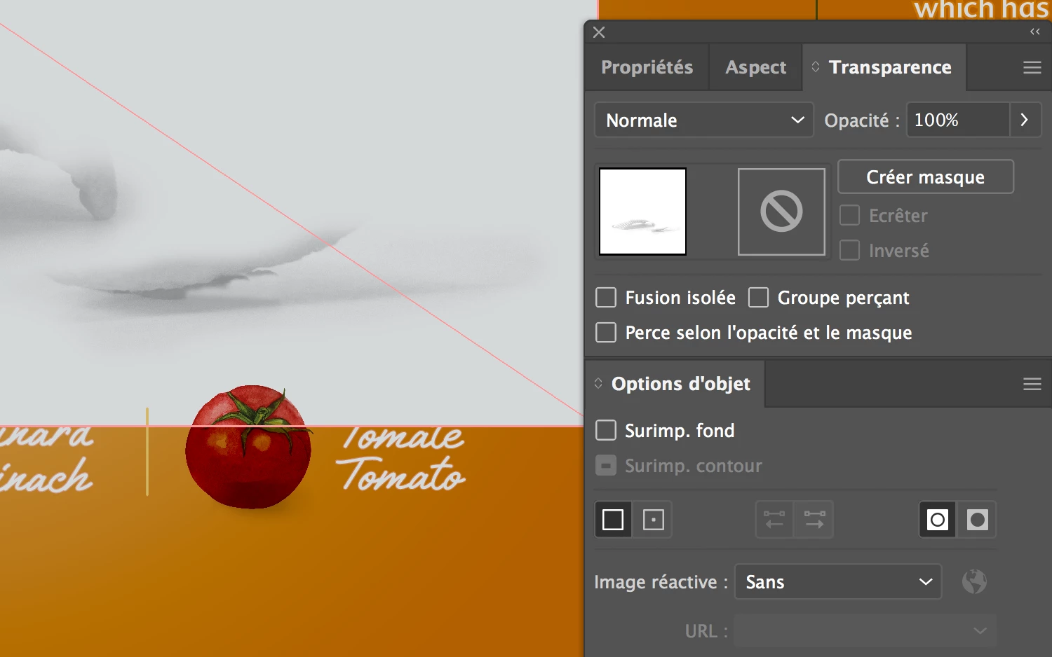

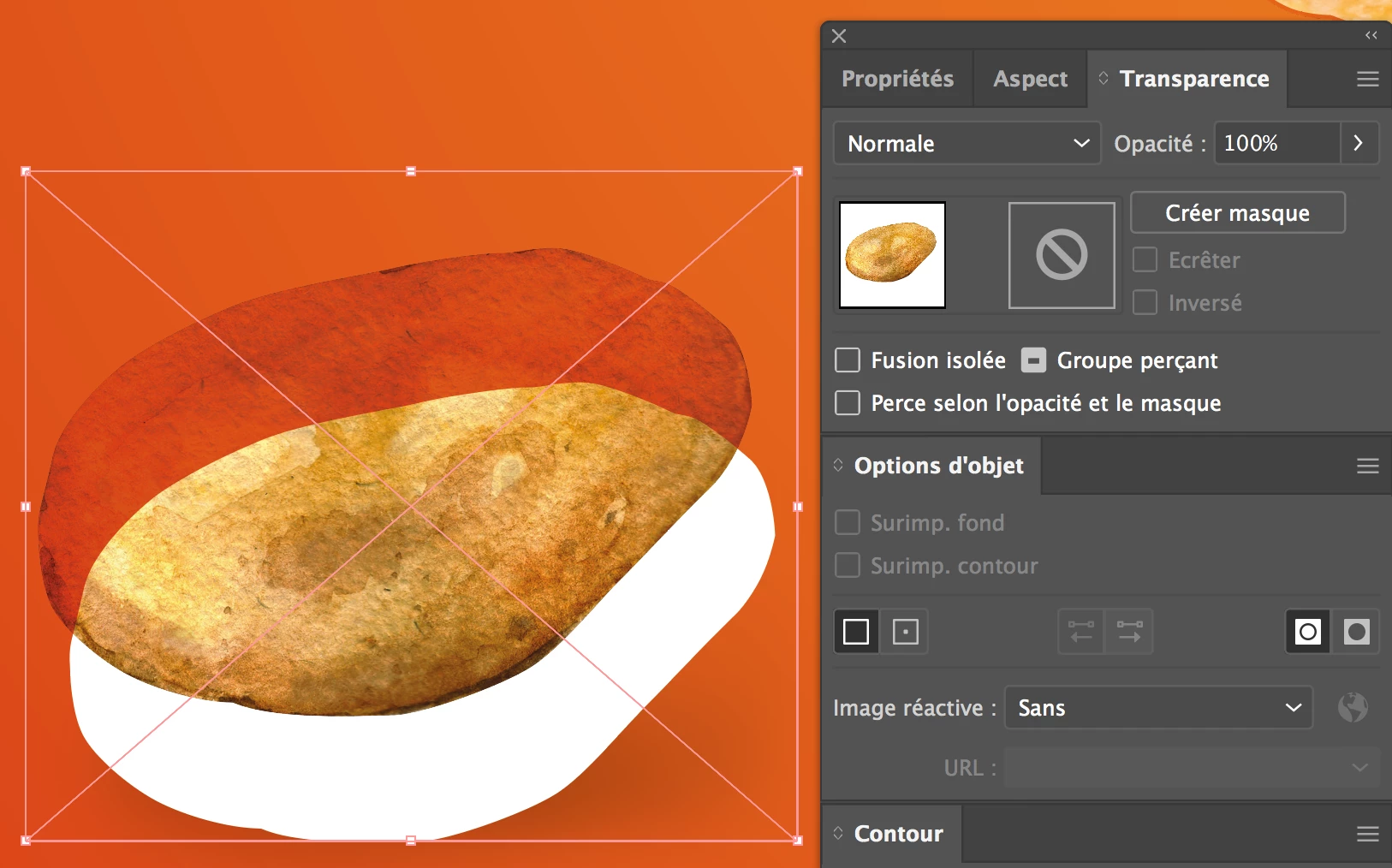

In my file from november 1 saved in illustrator cc 2019, there a potato image .psd linked. As we can see on the screenshot, the potato appears in overprint on the color background, but it is in normal blending mode (not multiply) and the overprint box is inactive and unchecked.
It appears so because when the file was saved in illustrator 2019, the image was linked and overprint activated. Illustrator 2020 understands this option and retains it but it is no longer available for modification (I can even make a color separation from the old file and the overprint of linked images works).
There is inevitably a bug in the new version because I can not edit any more options than I could before.

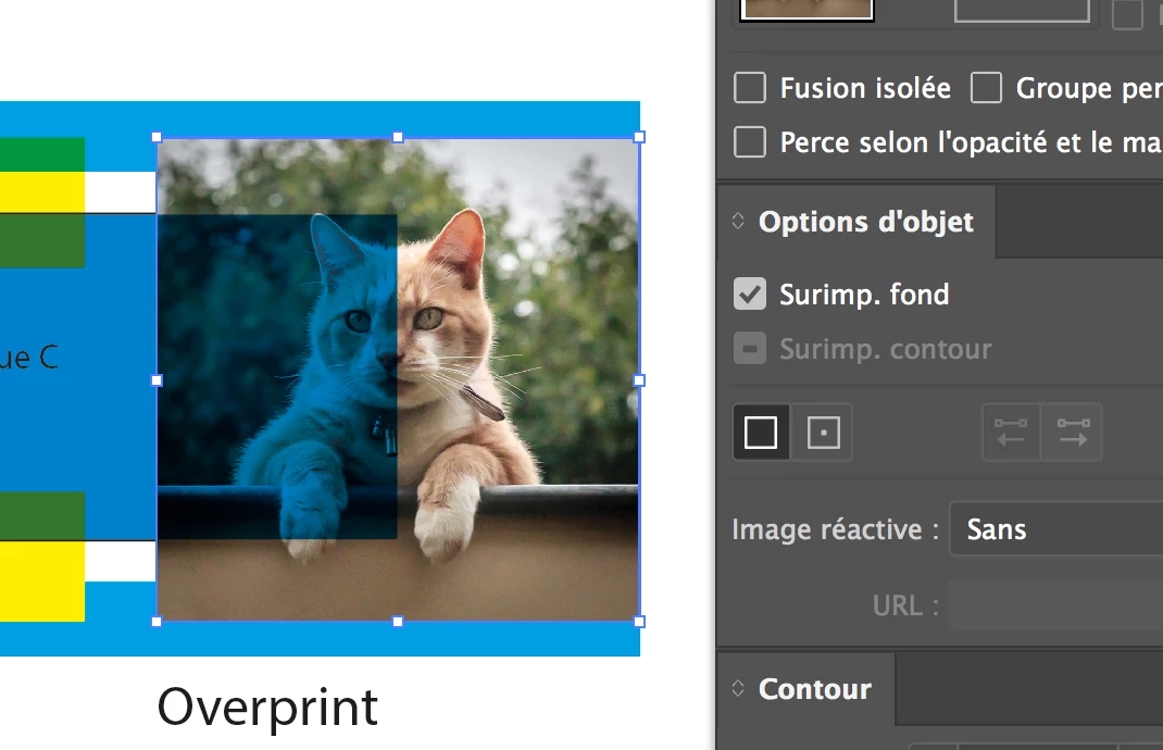

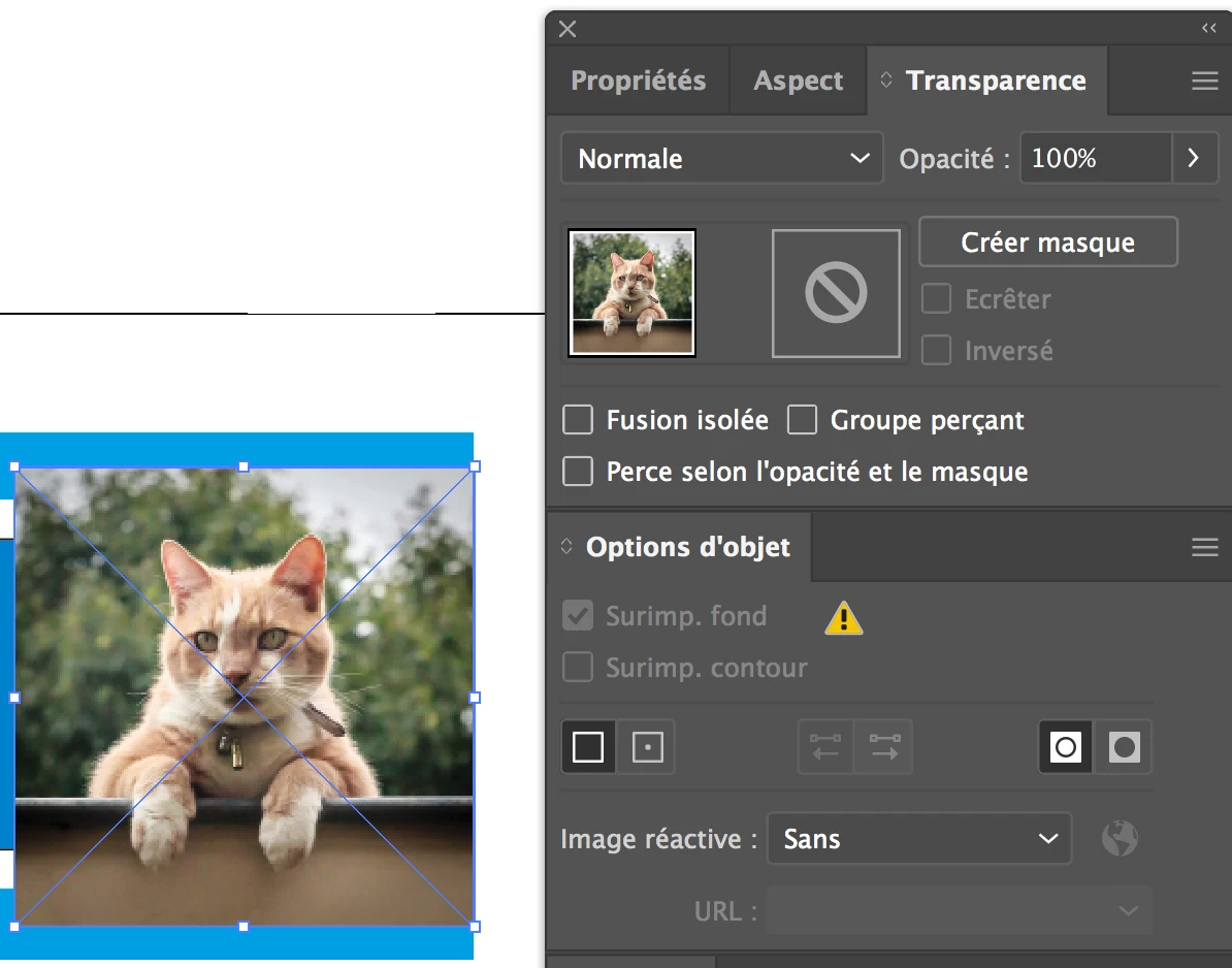

Try to open the enclosed PDF in Illustrator, and see if that works for you.
November 7, 2019
That work when the jpg is embeed, but not when it's linkk
JeffArdoise
November 7, 2019
So just embed the file, and I see that it's working for a CMYK and not just a grayscale. What is still the problem?

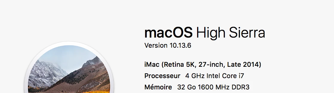

November 7, 2019
I use High Sierra

The only way to check the overprint option on an image is to embed it in Illustrator first, although I'm not sure why you would. What result are you trying to accomplish?
November 7, 2019
I need to put the image overprint (I do not want to check) to go on the presses in large quantities. The option is simply not clickable on the images now. As my screenshot shows. I'm doing color overlap (CMYK) of the image on a pms background. Why the option is no longer available I have been using it for 15 years.
November 7, 2019
I just noticed that if the image is in grayscale, the option is available. Why is it not available for CMYK images?
