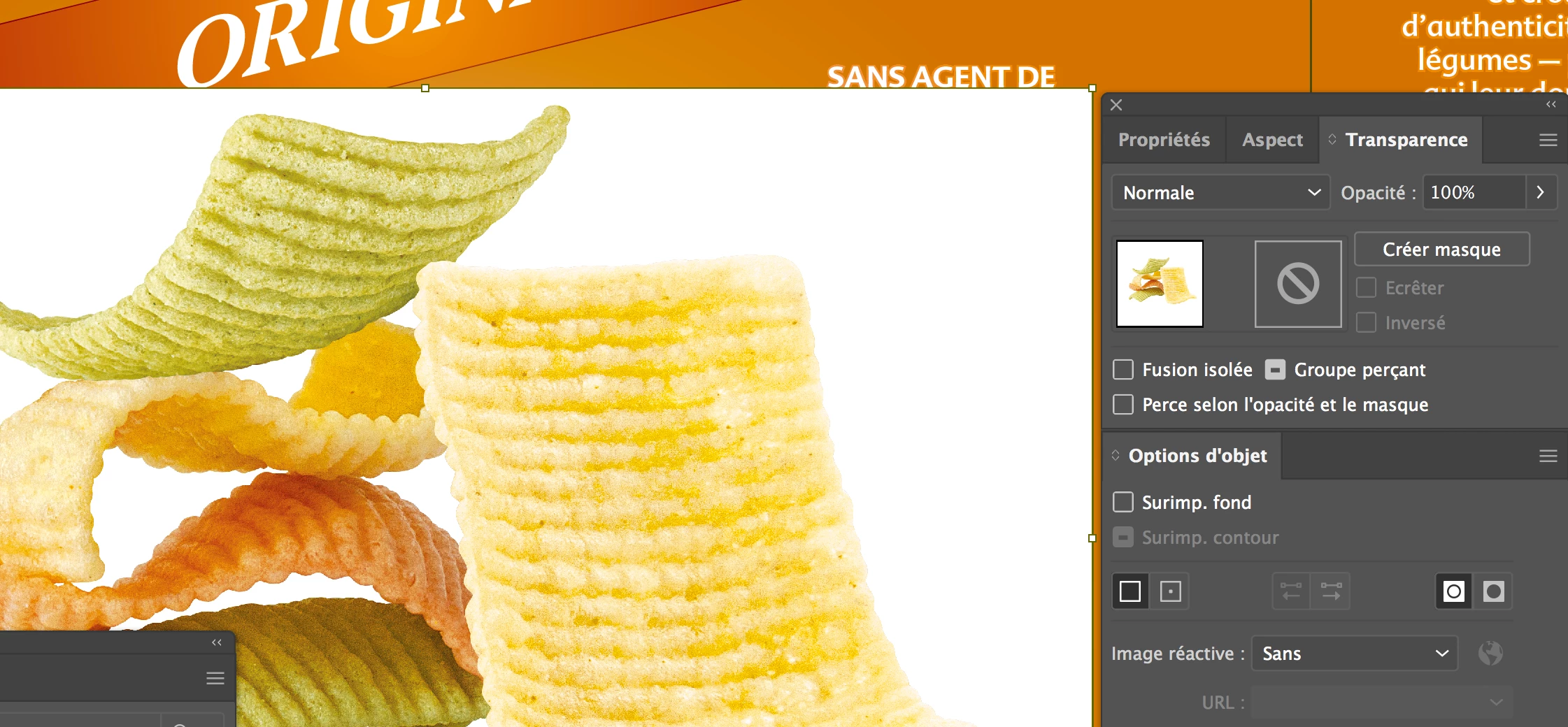

I can not check the overprint option on an image (the option is present but inactive). On the vector elements it works. Is there a new way of doing things?

This option is available from illustrator 8 (the .psd was not supported at the time, we used the .eps.). The first thing we learn at school was « always link your image ». For a smaller file size and the auto-update when you modify the image source.
In my file from november 1 saved in illustrator cc 2019, there a potato image .psd linked. As we can see on the screenshot, the potato appears in overprint on the color background, but it is in normal blending mode (not multiply) and the overprint box is inactive and unchecked.
It appears so because when the file was saved in illustrator 2019, the image was linked and overprint activated. Illustrator 2020 understands this option and retains it but it is no longer available for modification (I can even make a color separation from the old file and the overprint of linked images works).
There is inevitably a bug in the new version because I can not edit any more options than I could before.

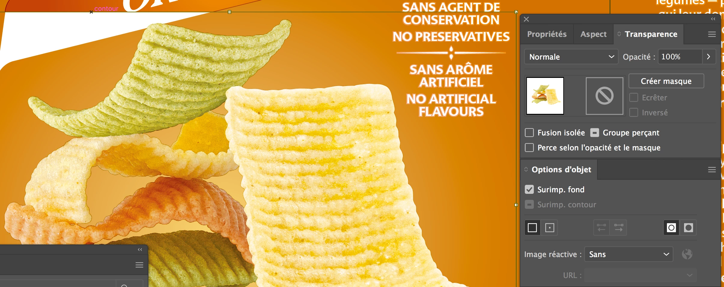

That work when the jpg is embeed, but not when it's linkk

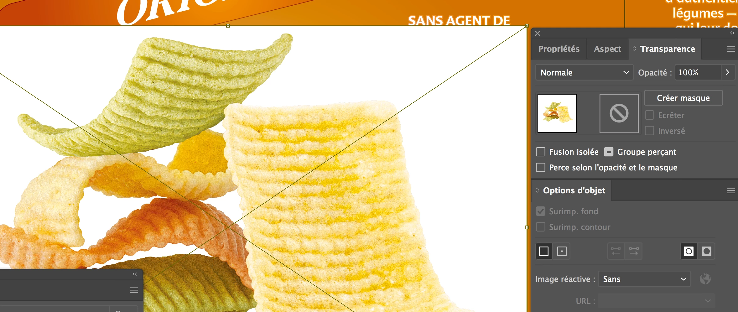

I need to put the image overprint (I do not want to check) to go on the presses in large quantities. The option is simply not clickable on the images now. As my screenshot shows. I'm doing color overlap (CMYK) of the image on a pms background. Why the option is no longer available I have been using it for 15 years.

I think it's from the .psd format of the process image. Before it was possible. I tried with the same image in .jpg and it works only when the image is embeed but created another bug. The overprint overwrites the process colors.
Then if I put the same image .jpg but bound (not embeed). The overprint option becomes inactive but remains checked ???? and the display does not seem to apply the overprint.

Thank you very much. I know but i prefer to use the overprint option. Multiplys blending mode is not the same. I download the old version 2019 and the option dissapear too... ( Maybe because the last update ). My 2019 file keep the overprint on image that already was ( Blending option set as normal ). But i see the overprint whent i'm on overprint preview.
