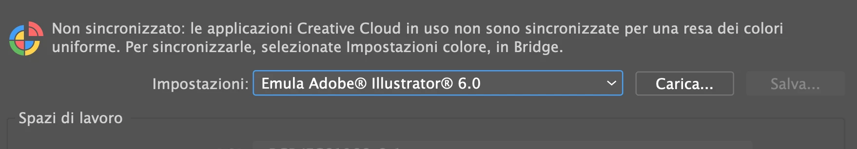

Hi everyone,
everytime i go on other software like Ps, Illustrator automatically changes it's color profile to "emulate adobe illustrator 6.0" settings.
It doesn't matter if i made a personal color profile settings, everytime i open other app, like Ps, it changes by itself. Really frustrating. Any way to solve this issue?
Correct answer Ton Frederiks
There is a bug caused by the recent Photoshop update. It sets your Color Settings to Emulate Illustrator 6, which turns color management off.
Use the CC app to revert Photoshop to the Previous version (22.2.0) and then change your Color Settings to what you want it to be.
Ton Frederiks
Ton FrederiksCommunity ExpertCorrect answer
March 28, 2021
April 5, 2021
I just reverted back to the previous version of Ps but I dont know what color settings i was using prior to the bug changing my color settings.  What is the default color settings for illustrator as I believe that is what may have been set.
Thank you!
Ton Frederiks
April 5, 2021
Probably one of the General purpose presets. If you live in Europe, the European.
