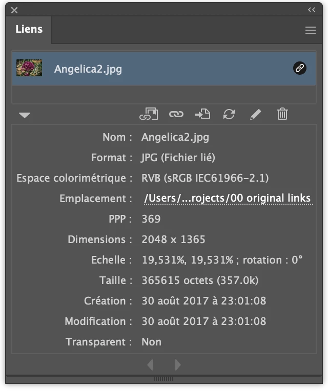

The advice that Jacob gave should help you with your current images.
Illustrator should read the resolution metadata and scale the image to the correct size.
Check if the resolution is correctly set and saved in the file.
You can go back into an Image editor like Photoshop and set the resolution in Image > Image Size  and Uncheck the Resample option to keep the amount of pixels the same.

Gaétan, what does your Links panel tell you about PPI and Scale?

Gaétan,
Whichever size the JPEGs appear at, you can just scale proportionally to the right size and work with that.
This can be done in different ways.
One is to use the Transform palette based on a known desired real size in H (height) or W (width). You can select a letter, then simply change the number in the H or W box, then insert the desired real number and hold Ctrl/Cmd while you press Enter, to immediately see that it has the right size and unchanged proportions.
Another one is to scale with Object>Transform>Scale which uses percentage where 100% is keeping the size. You can insert the following in the Uniform box:
Desired real size multiplied by 100 (just add 00 after a whole number, remove the punctuation mark and add 0, or move the punctuation mark two places to the righ), then / (for division), then the current real size.
When the current size is about twice the desired real size, the result will be about 50(%).
