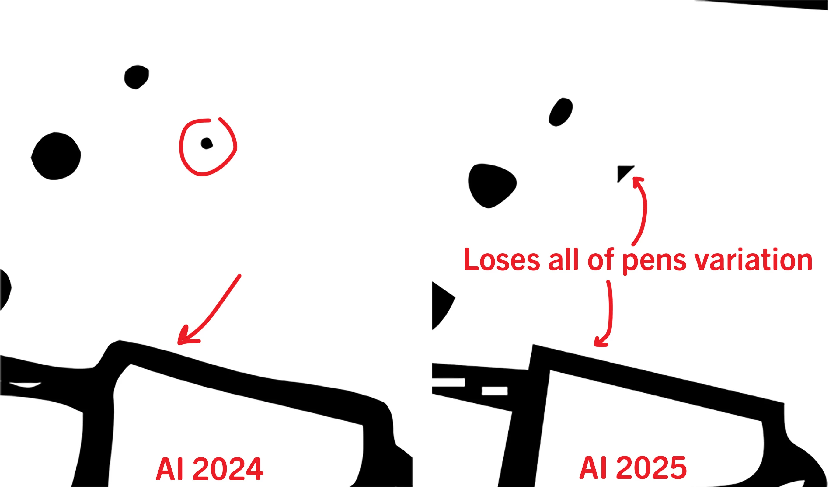

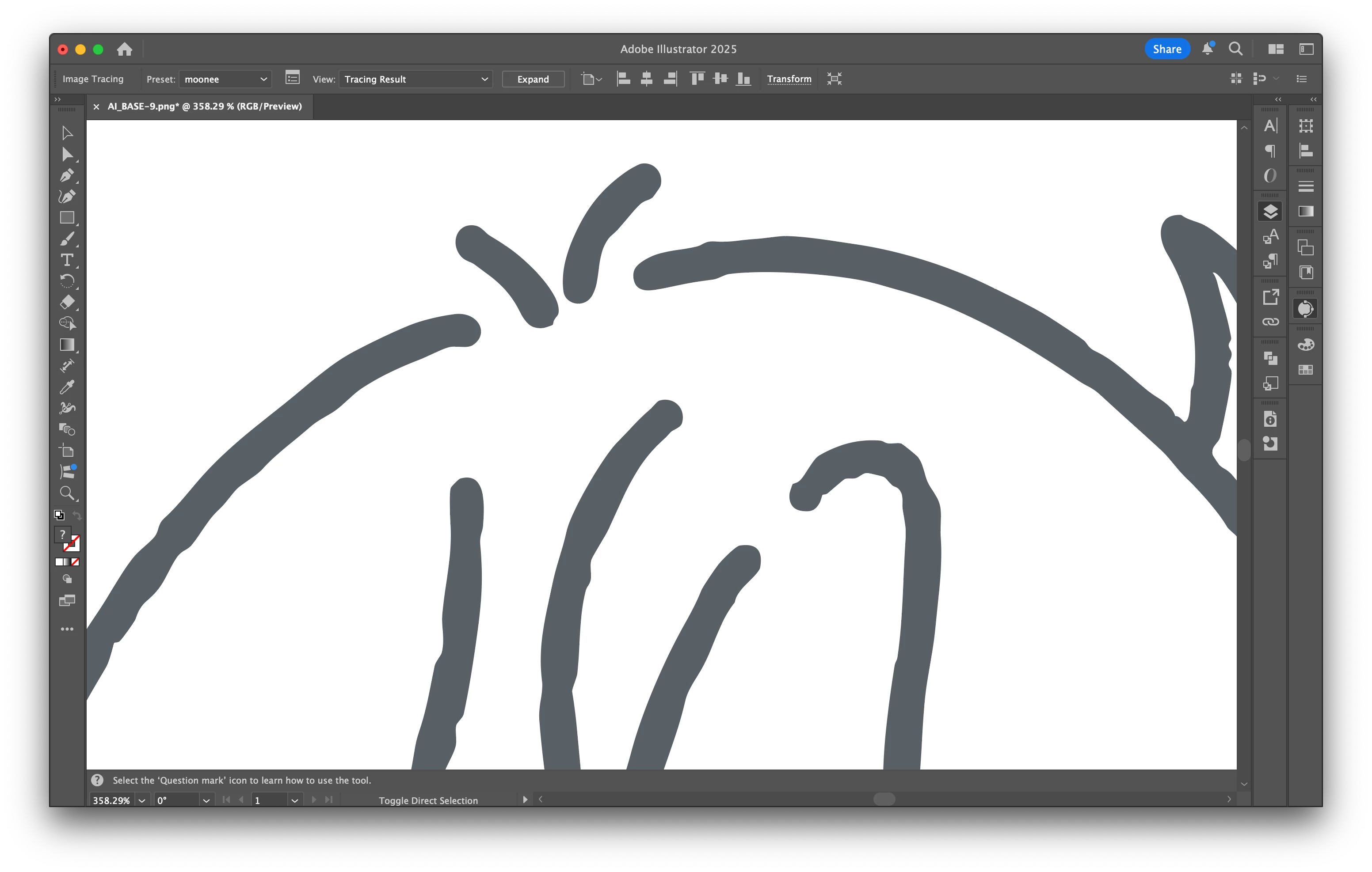

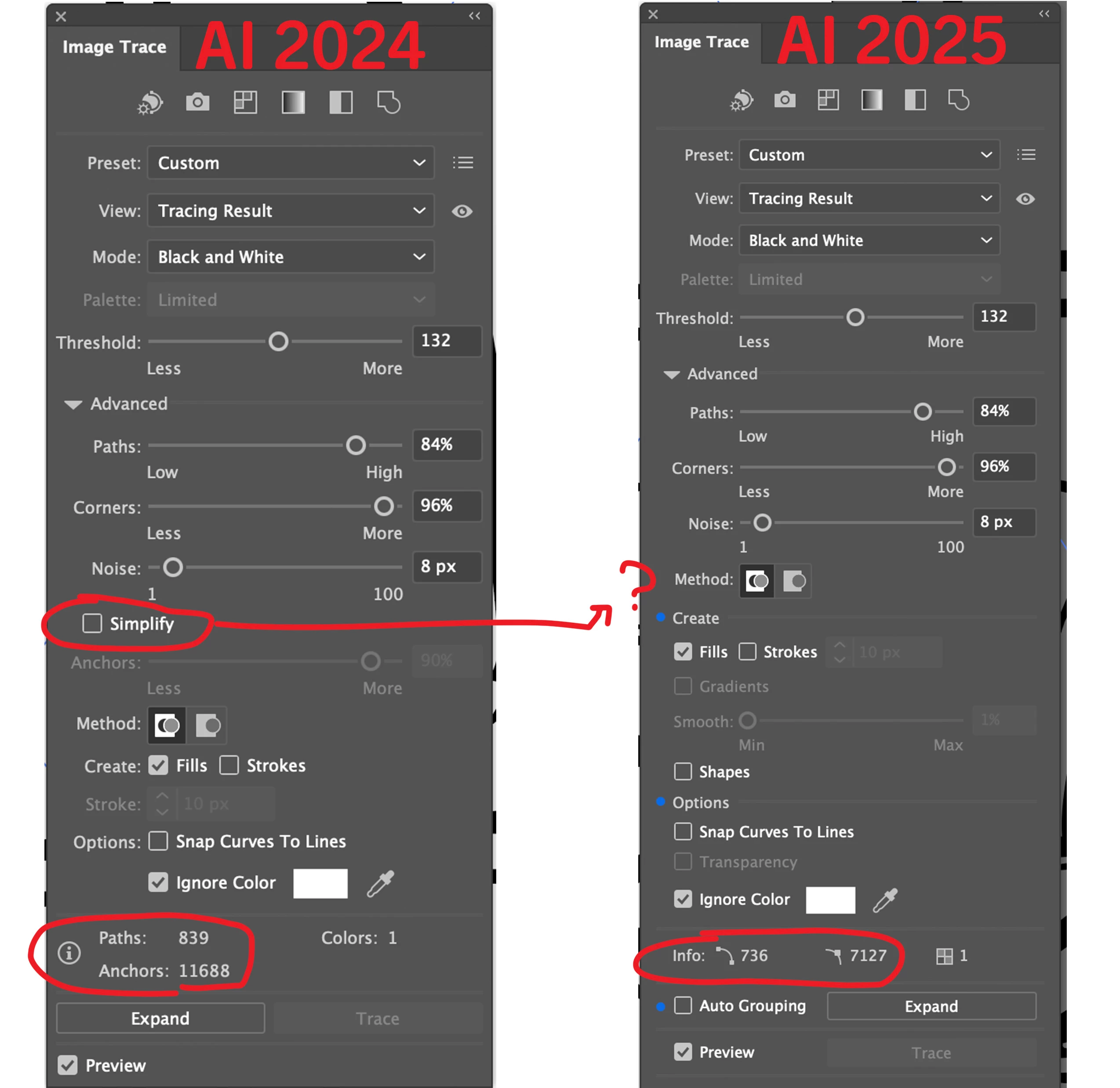

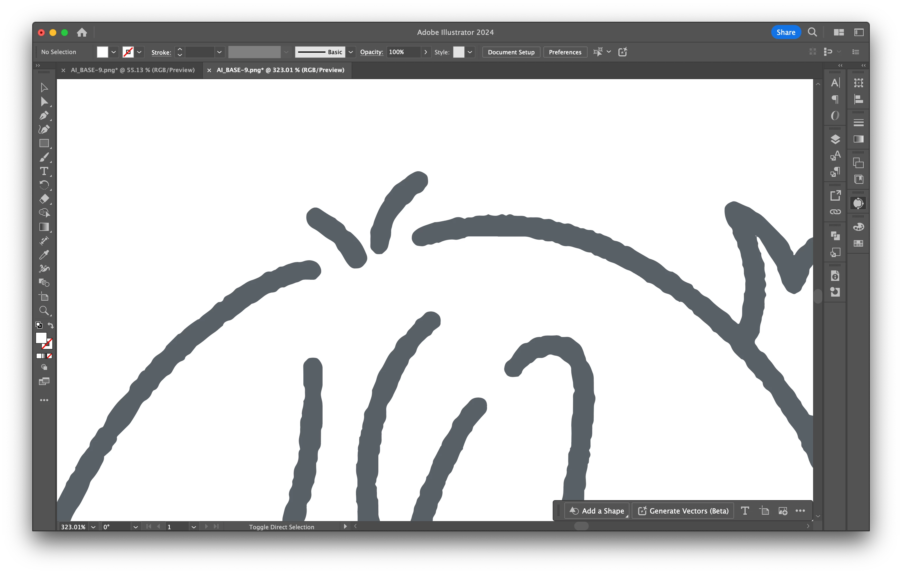

HI, Image Trace in the 2025 version performs much poorer than previous versions from the last few years. It took me a while to figure it out but the new version has left off the Simplify check box and it seems to be stuck ON by default.
I'm an illustrator who scans my illustrations into illustrator and then uses Image Trace to vectorize them. With the "simplify" automatically on I am getting poor results and so have had to downgrade to AI 2024. Is there anyway to gain control of this again?

I've been working on a VERY important project since last year and was on holiday. I just started working on it again this week, now using 2025. i was about to cry as i couldn't get the results i wanted and knew for sure was working before in image trace. i've been on it for hours. same settings as before but the lines were so much smoother which i specifically didn't want. Until i tried it again on 2024 and got the results i need back!

No. You can see my advanced settings are identical in the images below, but
in 2025 the simplify box has been removed and appears to be on by default
(I don’t want the image simplified any more than it needs to be).
