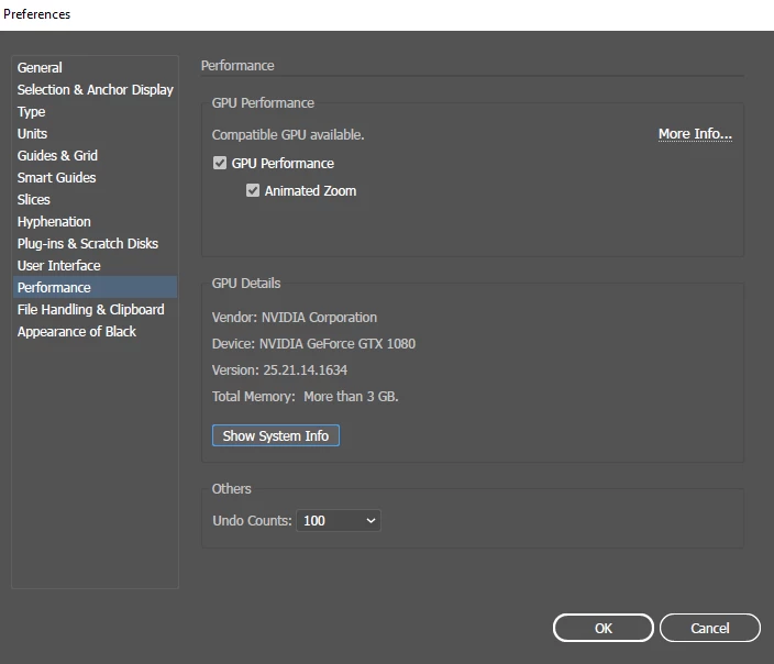

    November 19, 2018
    Can you take a look at your preferences and go to the Performance and tell us what the GPU  says?
    GearlessAuthor
    November 19, 2018
    Hi, here is a screenshot.
    Or do you need the text information under a "show system info" button?
    November 19, 2018
    I had something similar with the graphics card not showing up and had to change the cable for the monitor for a different port. But doesn't seem to be the case here.
