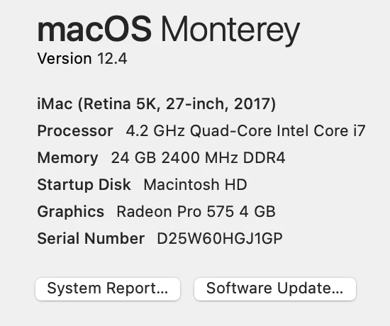

Can you tell us about your hardware?
When was the last time you rebooted the computer?
