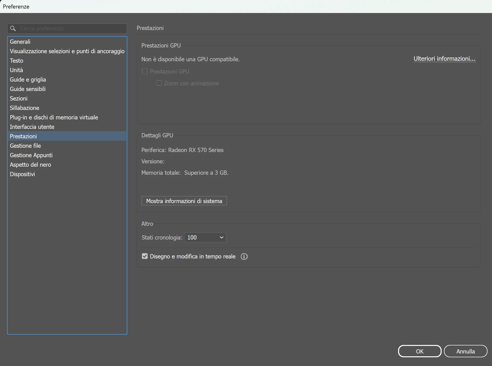

    Same problem here, The gpu is detected by windows and photoshop, but is not available in illustrator… here is a screenshot:

    Hi Zealous_Brilliance8a1b,
    Thank you for reaching out, and sorry for the trouble. Would you mind performing a clean reinstallation of the GPU(s) drivers (Intel / NVIDIA / AMD) and setting the Graphics Preference to High-Performance for Illustrator (https://adobe.ly/3Swh2Ky) and checking if it helps?
    Please also try manually resetting Illustrator's preferences by following the steps below, and let us know if that helps.
    For Windows
    - Close all Adobe applications.
    - Go to Location C:\Users\%USERPROFILE%\AppData\Roaming\Adobe
    - Rename Adobe Illustrator and Adobe Illustrator 28 Settings folders to Adobe Illustrator.old and Adobe Illustrator - 28 Settings.old
    - Relaunch Illustrator from the Creative Cloud app.
    Disclaimer: Please note that renaming preferences folders will remove all the custom settings, and Illustrator will launch with default settings. You can also save a backup of the folders in case you want to. The location is mentioned above.
