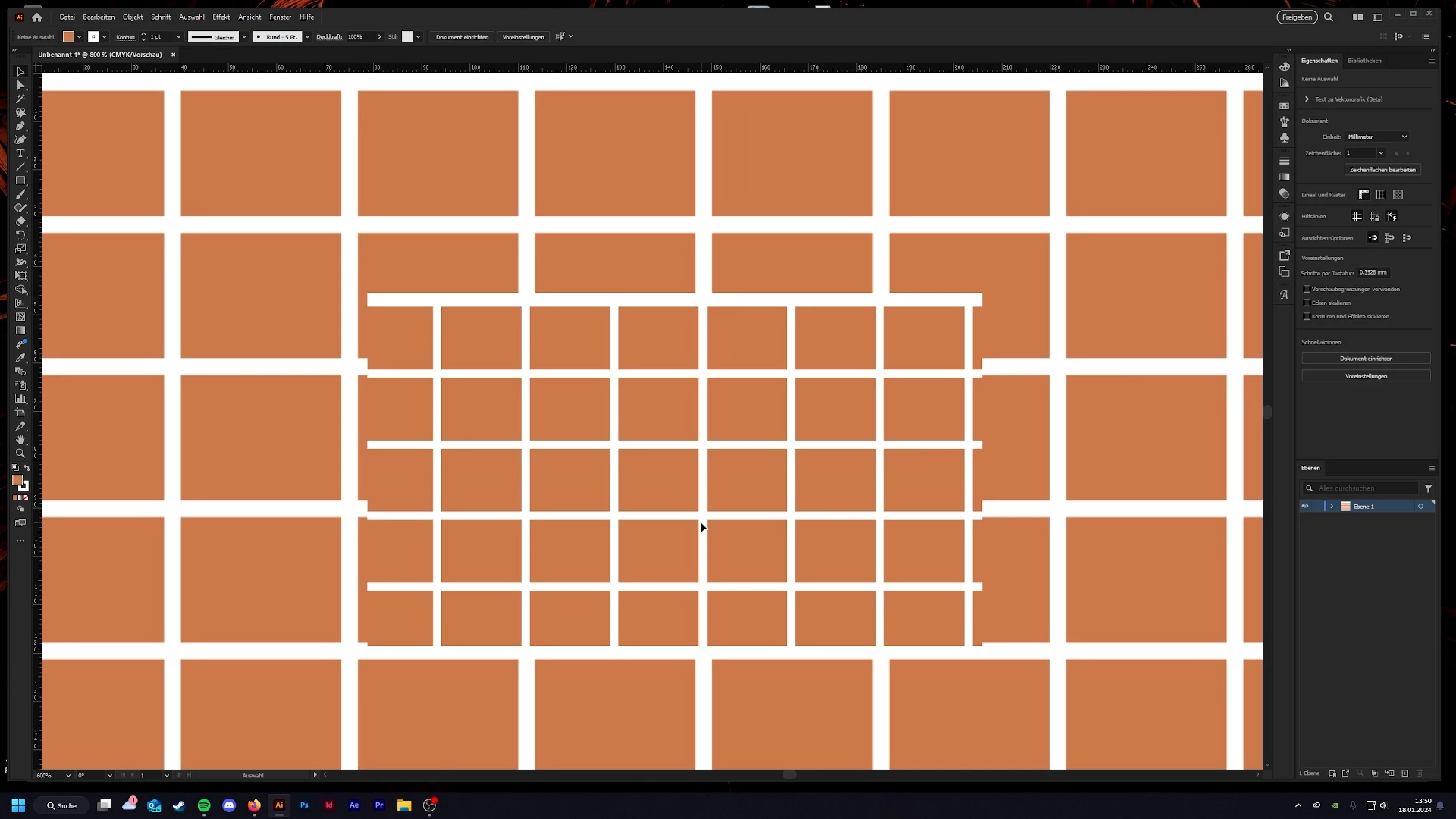

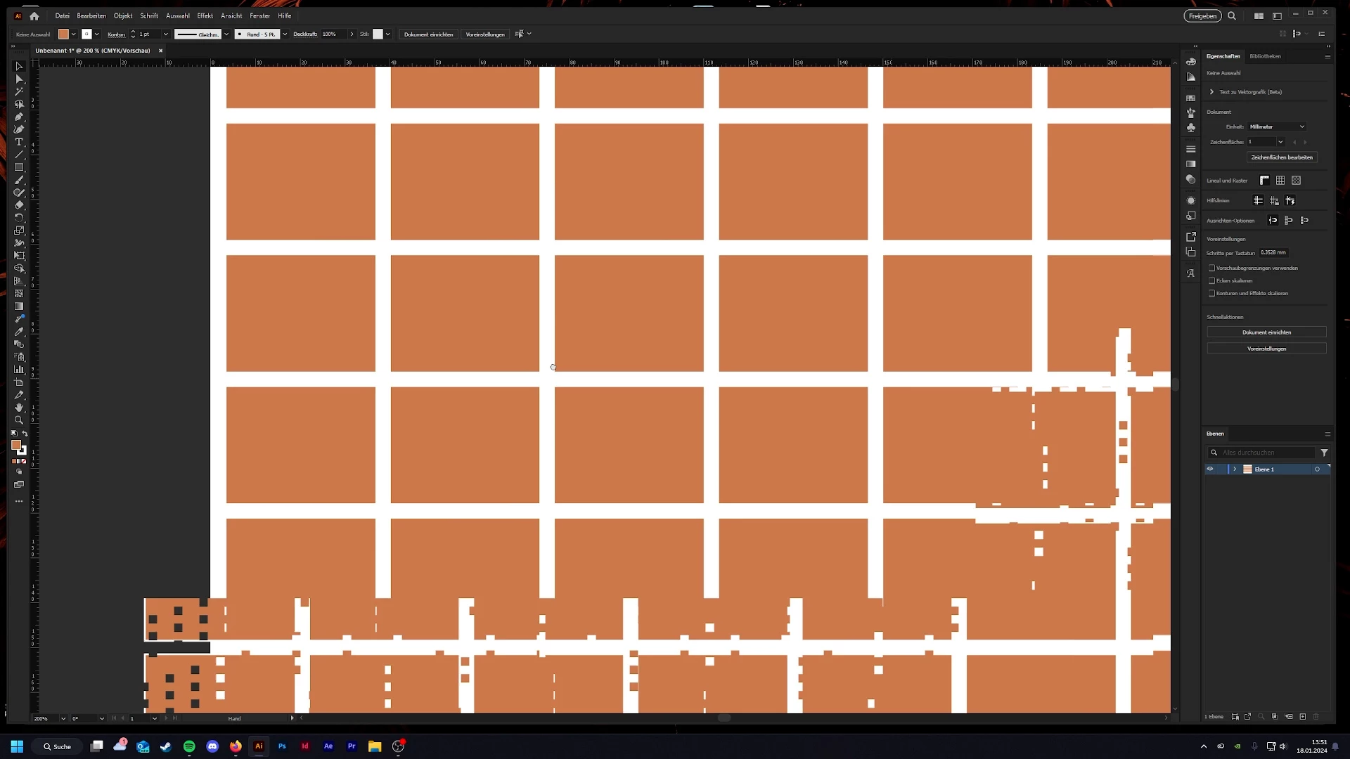

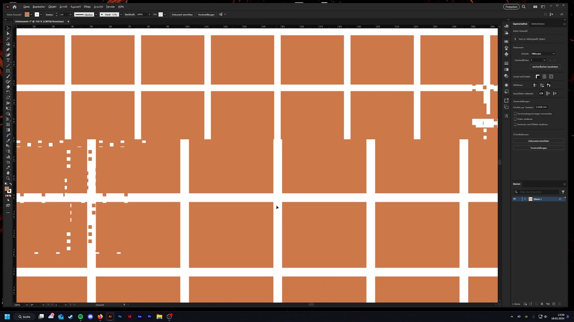

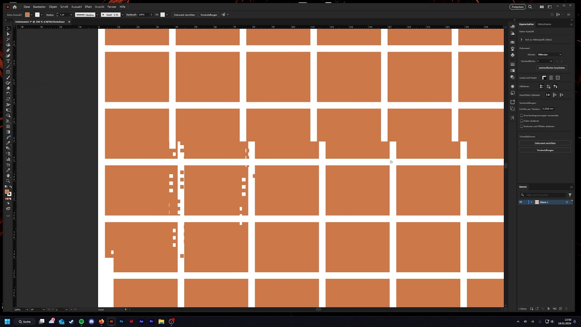

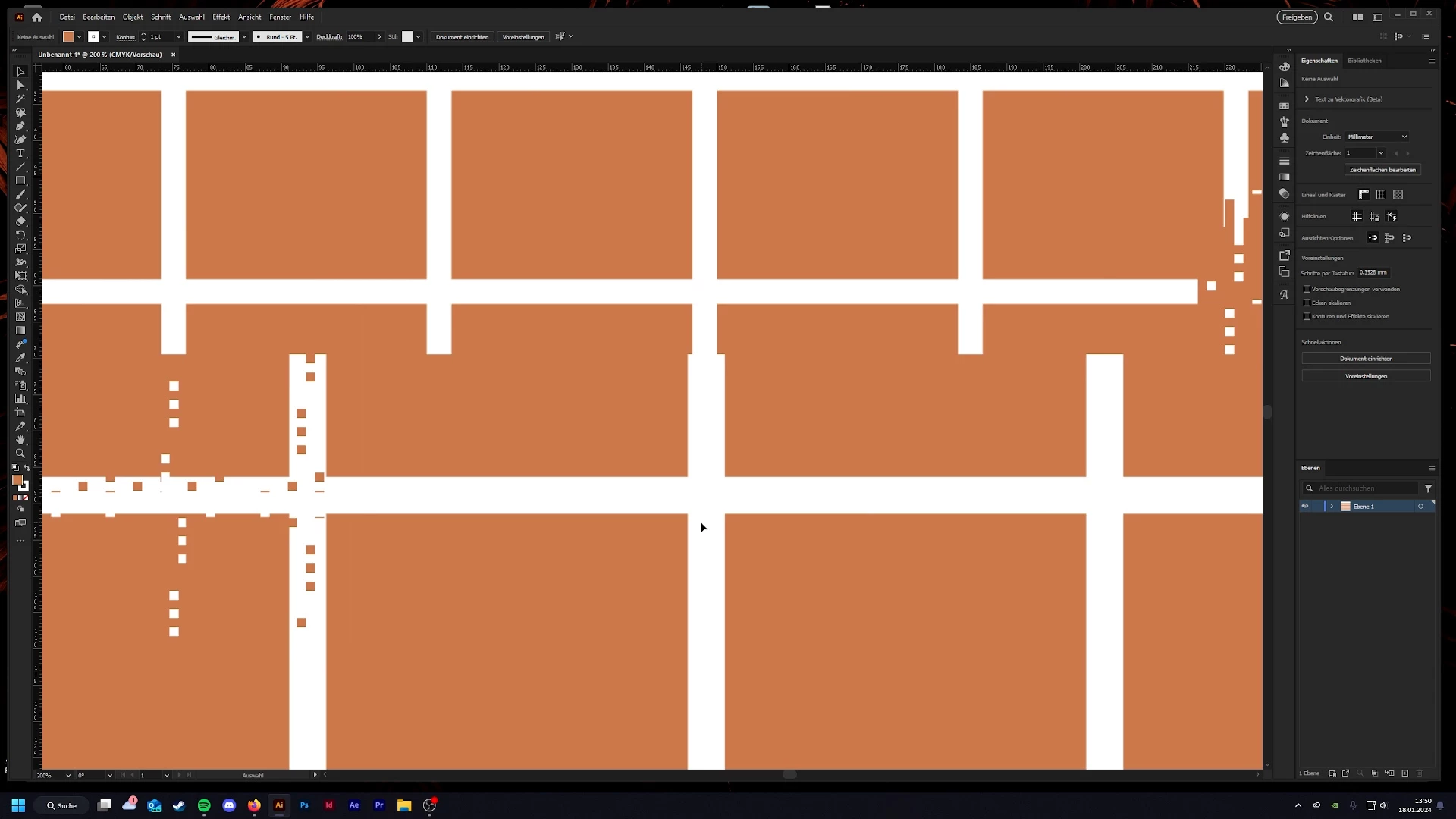

Hi Illustrator Team,
since updating to AI Version 28.1 im getting weird Artifacts when panning and zooming in on Artboards.
It always happens, especially when there are a lot of Objects or Fonts. Its becoming really distracting when working.
There is also a Delay of about 1 Sec. before the zoom/pan finishes
Problem Only Occurs when using GPU. CPU Preview functions normally.
I have reset the Prefs (and deleted the Folders), reinstalled Illustrator, reinstalled Graphics Drivers (and downloaded older Drivers) & Updated Windows and nothing seems to help.
System Specs:
  • Windows 11 (23H2) with latest Updates (Build: 22631.3007, Experience Pack Ver. 1000.22681.1000.0)
  • Ryzen 5800x
  • RTX 3070 (Studio Driver Ver. 546.33)
  • 32GB DDR4 Ram
  • 4TB Samsung Evo 970 NVME
  • 2560x1440 120HZ Display
Attached is a Video of the Problem and Screenshots of the Artifacts.

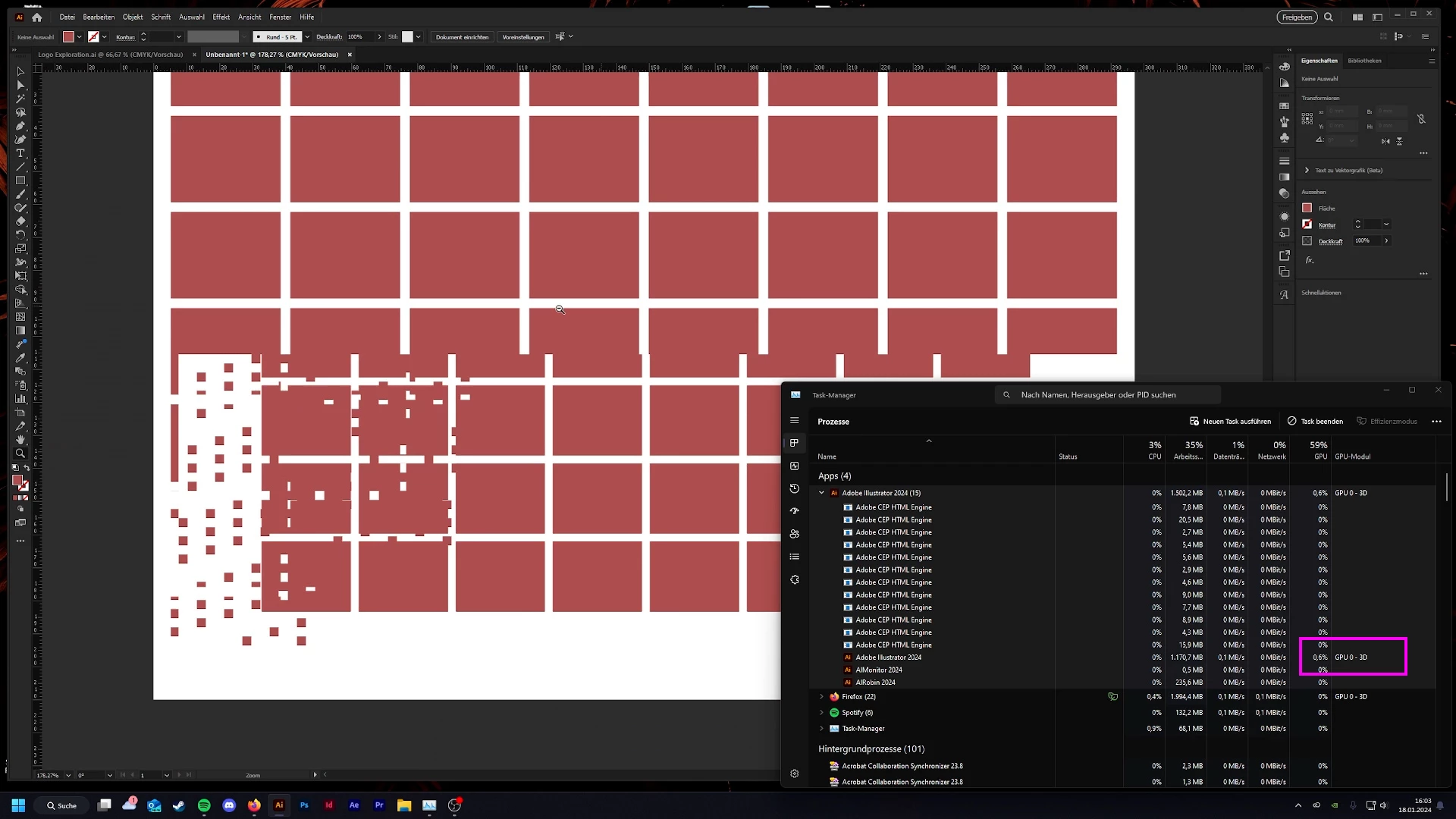

I found a curiosity though, it seems to happen when the GPU Modul is initialized (see attached Video, Task Manager), when the Modul is "on" there seems to be no Artifacting, only in the beginning when the modul doesn't seem to be present or isn't initialized yet.
It also seems worse when using ALT + Scroll, when using scrubby zoom via the zoom tool, the artifacting  just happens in the beginning.
After a while, when Task Manager is showing no GPU Module and you start to zoom again, the artifacting and delay comes back.
Hope this helps narrowing it down. Thanks again!
