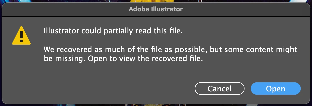

Illustrator can only partially read this file...in Illustrator 2026 only
I've been working with a file off and on without issue, and today I tried to open it to receive a "Illustrator can only partially read this file" error, and it to open it all as links.
I downloaded a way back previous version of the file from my cloud to receive the same error.
Pulled up Illustrator 2025 and opened the original file and the old version, both without issue.
Reeeallllyyyy?? Come on Adobe. I don't have time for this. Why suddenly can't I open a perfectly fine file I used yesterday in Illustrator 2026, I now have to use Illustrator 2025. This is insane.
Running OS 15.6.1, Illustrator v30.1

HI @Anubhav M -  have installed the latest beta of Illustrator now (v30.3 beta) and opened one of the files that was affected. And confirm that this issue seems to have been fixed in the beta. So thanks for that. I will contnue to run v30.0 for now until a new verison arrives (would this be the next release or would there be a v30.2 beforehand that potenrtially would still have the issue?).

I've been dealing with a similar issue. My workplace has a couple of CorelDRAW installations; the app can export files in Adobe Illustrator format. But if those .AI files have any live text objects in them they will not open in either versions 29 or 30 of Adobe Illustrator. The files will not open in the beta version of Illustrator either. That same error box gets displayed, "Illustrator could partially read this file." The file opens as a blank document.
I'm having to keep a copy of Illustrator 28.7.10 installed just to open Corel-generated .AI files and re-save them so they'll open in the current version of Illustrator.

For the moment a fix is to downgrade to v30.0, which you can do from the Creative Cloud app (click the 3 dots next to the app and select a previous version to install). Files open fine again. I'll test the new beta later today and let the group know if it fixes the issue too.
However, you'll need to set any preferences again and custom workspaces, plugins and suchlike, as the downgrade will erase all traces of the current version.

I am getting the same issue with latest version of Illustrator (v30.1) - it's happening on quite a few diffrerent files that were totally fine in the previous version of AI, all of which I know are perfectly fine (not corrupted) files. It definitely seems like a (pretty serious) bug. Now I need to find a way of downgrading to an earlier release.

I'm sorry to hear you're having similar trouble with Illustrator. Could you try installing the latest Illustrator (beta) release (https://adobe.ly/49v3CnL) to see if it helps?
