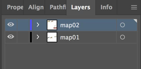

November 18, 2019
I've had a similar issue- it turned out that it was a case of order within the layers. I have had created 2 separate groups of layers and the image I wanted to arrange was simply making part of the group that didn't interact with my object at the time, so I had to simply go to the layers menu and move the layer from one group to the other. Hope it helps 🙂

>No, they aren't on the same layer...should they be?
Not necessarily: it would probably be convenient to have the squares on the lower/lowest layer, and possibly the objects on different layers, obviously with the foreground in the highest layer, to completely avoid any mess.
July 23, 2016
It's correct object on the different layer that's why getting this error...
