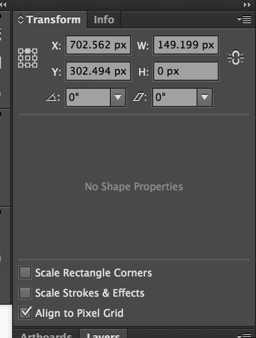

Correct answer Monika Gause
It's not a bug.
New rectangles are always live rectangles. Live rectangles cannot be aligned to the pixel grid because it would break them.
What you need to do is convert your live rectangles to paths (using the command in Object > Shape) and then align them to the pixel grid (by checking the option in the transform panel). You can do this for all of them at once.

Monika Gause
September 29, 2014
Align to pixel grid is an object based attribute. You have to turn it on in order to use it.
A live shape can't be aligned to the pixel grid. You have to convert it to a normal path in order to be able to turn on align to pixel grid.
You need to check your objects after handing them from file to file or from version to version.

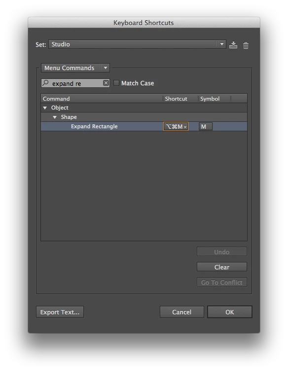

September 18, 2014
This is so incredibly obnoxious. I just installed Adobe CC the other day and was wondering why nothing was snapping. I thought I was going crazy.
It would be great if Create Live Rectangle was an option in settings that could be turned off.
For now, this is what I'm doing to speed up my process. I'm just setting Expand Rectangle as a keyboard shortcut. Does anyone on here know anyone at Adobe so that we could link them to this thread?
