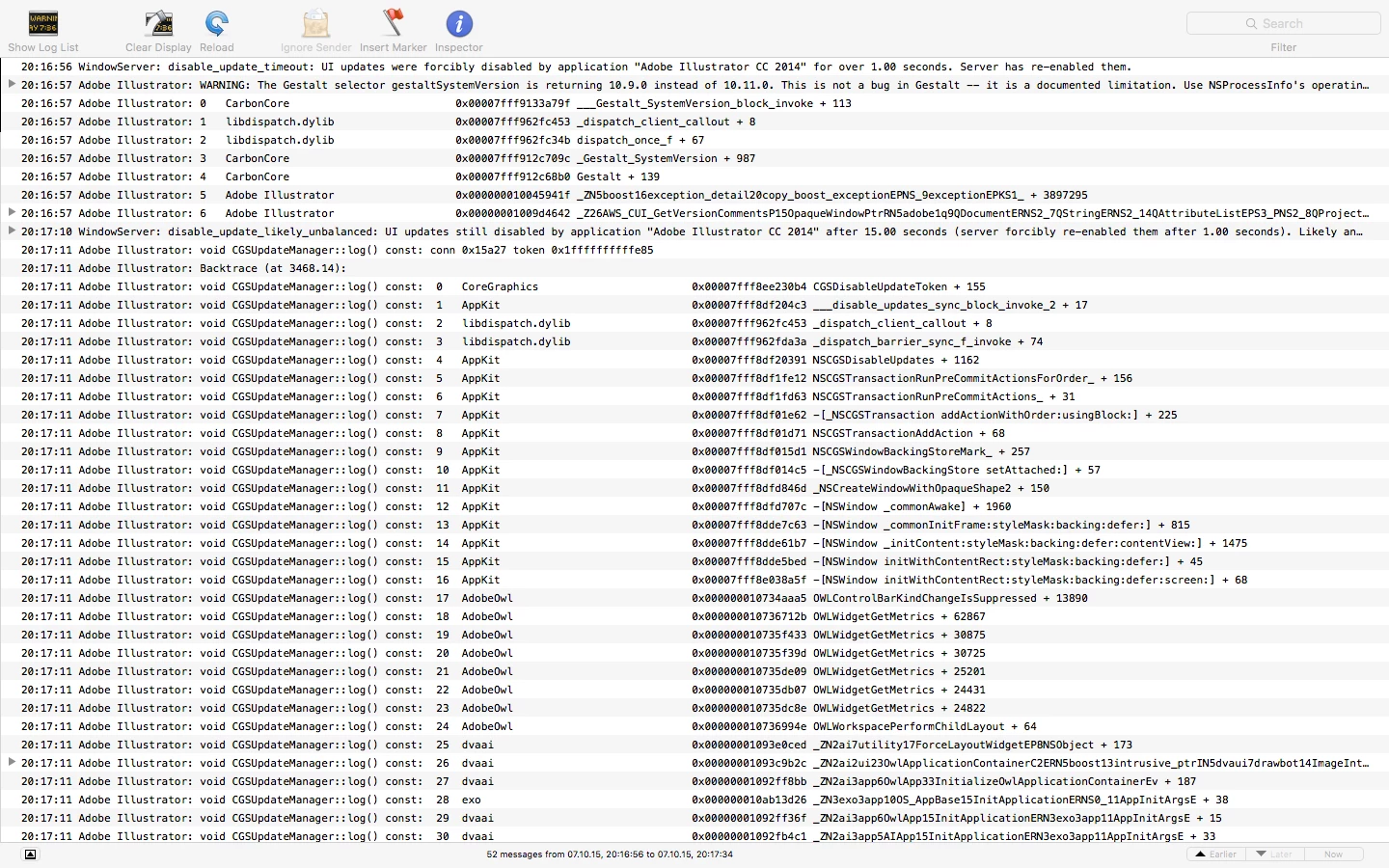

Seems to be crashing in an NSAutoreleasePool release, but it is crashing in the Illustrator app rather than your plugin. Do you use NSAutoreleasePool in your code? Maybe it is crashing when Illustrator tries to load your plugin. Do you have anything strange in your Info.plist or your plugin's rsrc file? Do you see any errors in the console window?

I've attached a screenshot of the console output.
Thanks in advance
