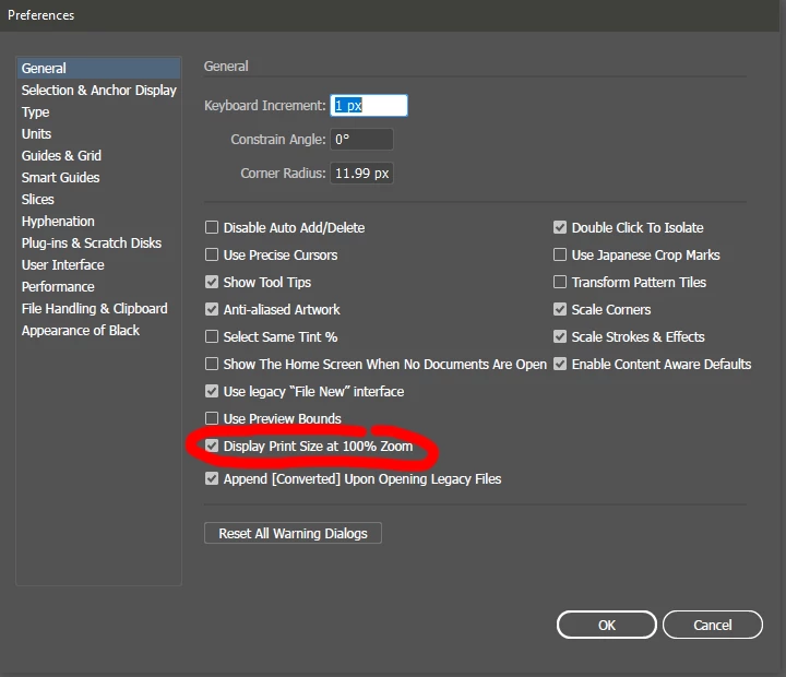

    The problem still persists on the latest build (23.0.1).
    Even with this box unticked in preferences?
