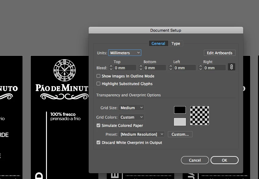

    I have made the most simple way.  I have created a black shape with my artboard size and sent it back
    Mar 7, 2019 7:16 PM UTC
    Go to FILE>DOCUMENT SETUP>click on SIMULATE COLORED PAPER
    Change color of upper color box to the desired color.
    Click OK
    If it does not change the background color press CMD + SHIFT + D twice. It should work.

    This does not set a background color. It simulates printing on colored paper. It makes white objects disappear.
    Mar 7, 2019 9:53 PM UTC
    I am just using this and all white objects appear just fine. I am simulating white printing on black paper.

    Another workaround, using File > Document Setup, you can make the two colors of the transparency grid the same and always work with Show Transparency Grid on which is accessible from the View menu (Shift + Ctrl + D)
