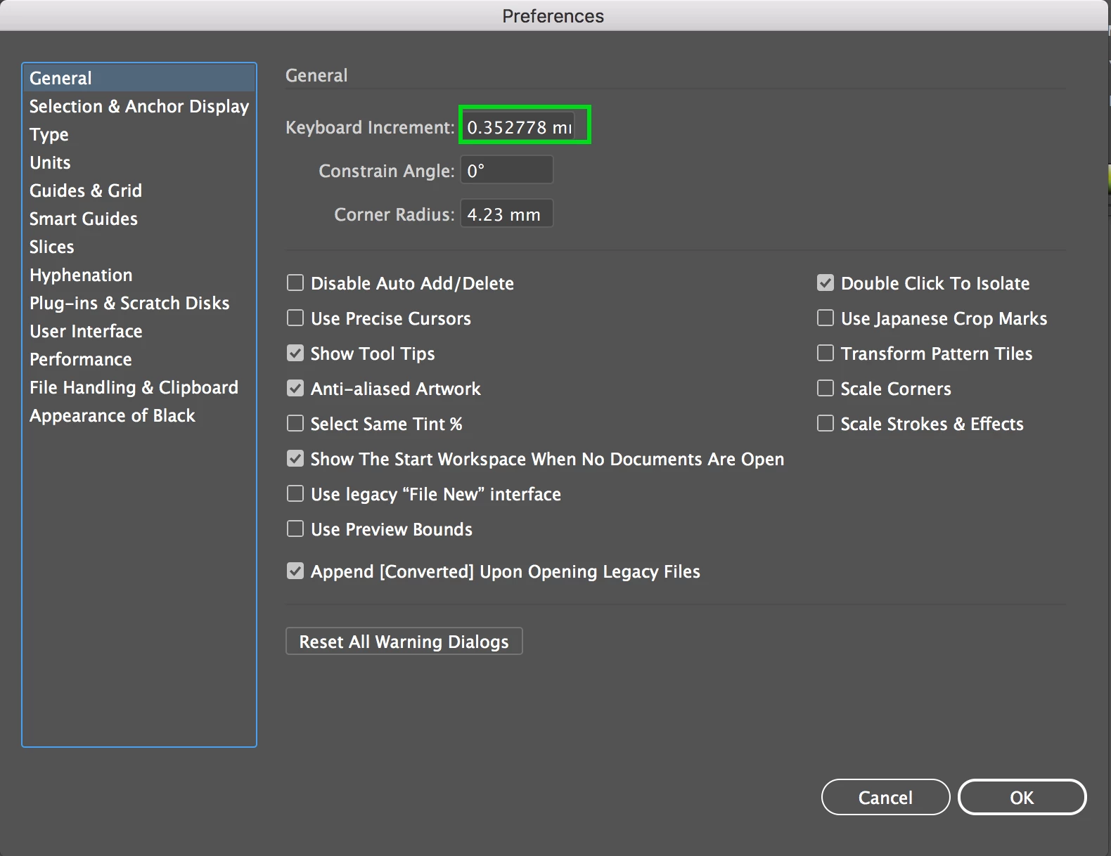

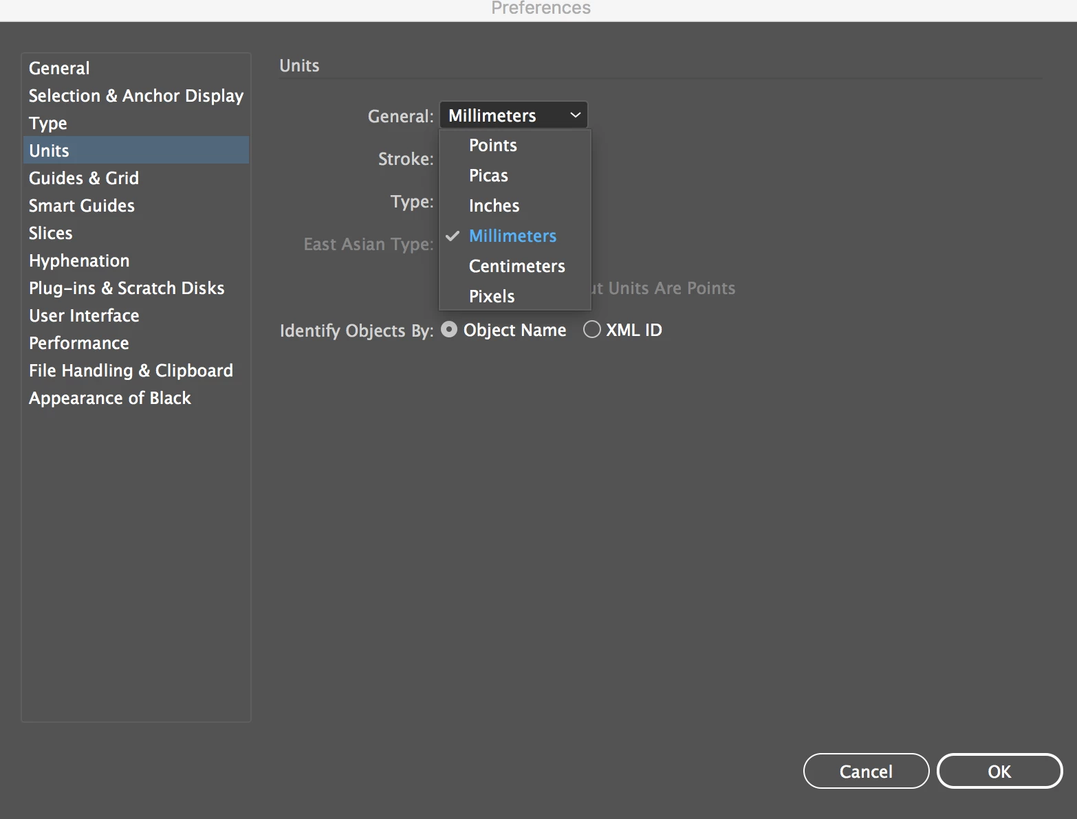

Hey,
Here is where you can change your Keyboard increment by typing a pacific number or highlighting the number and pressing the up or down arrows to increase and decrease respectively:
Go: Illustrator > Preferences
And here is where you can change the actual units of the increments:
I hope this helps!
February 26, 2018
Thank you, but as stated earlier by Alexandra, "I want to change the increment when you use the up/down arrows in the X or Y box."  I want to go back to having those increments at 1/8" but changing that in the keyboard increments preferences does not have the desired effect.  For example, if I change my keyboard increments to .125", using up or down arrow key in the X or Y box moves it a whole inch.  If I use "command + arrow", it moves it .48".  I used to be able to keep the keyboard increment at the default 0.0139 in, and have a selected object move .125" when using the arrow key in the X or Y box (while still having it move .0139" with the arrow key if my cursor was NOT in the
X or Y box.
