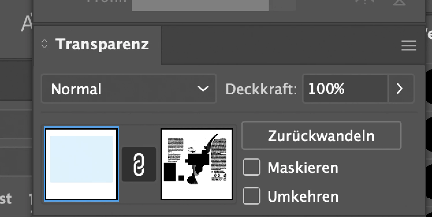

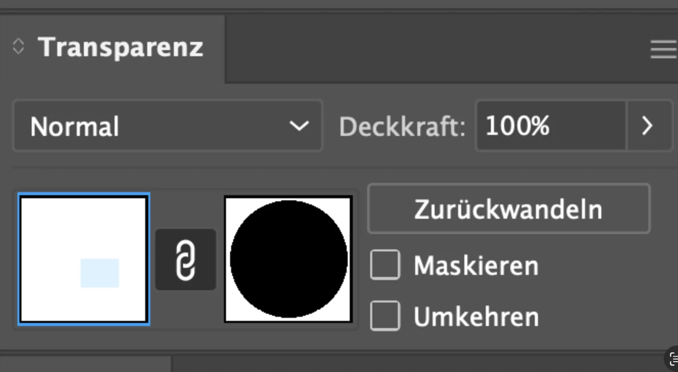

  • When we create transparency masks for certain jobs and save and reopen the file, they are completely destroyed (i.e., text converted to paths, other vector graphics, or even linked graphics are deleted from the mask, and, for example, only a circle is inserted) or the mask is moved to a completely different position. Even after adjusting the mask again this problem keeps recurring after saving, closing and reopening the same document.
    See attached files "1_MaskBeforeSaving.png" and "2_MaskAfterSaving.png".

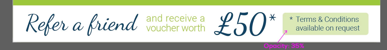

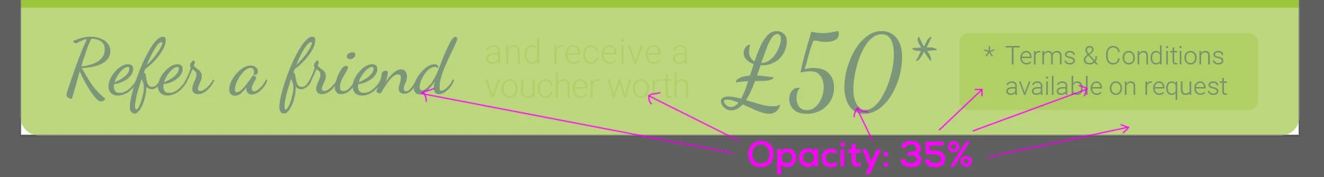

I have saved a screen recording of what is happening though - I have gone through the process twice in the recording - open the file (some elements which should be 100% opacity have 35% opacity), change opacity to 100%, save the file, close the file, open the file, change opacity again from 35% to 100%, save file, close file, open file. It is a continual loop. I do not know why it is not preserving the 100% opacity.

SImilar issue. I have an AI file created by myself in version 29.5.1. There are several elements within the file which have opacity 35%. When the filed is saved, closed and reopened, several elements with opacity set at 100% have also changed to 35%. I have saved and resaved many times. Deleted the bad elements and recreated them. Copied and pasted to a new document and resaved. Always the same problems
Have attached a couple of example images. Just a small portion as contains private customer information, but it affects many more elements on the page. On the first image everything is set to Opacity 100% except for one box which has 35% opacity. The file is saved and closed. When I reopen the file, everything else has been changed to Opacity 35%. This is affecting about 25% of the elements on the page and it does it EVERY time the file is saved, closed and reopened.
