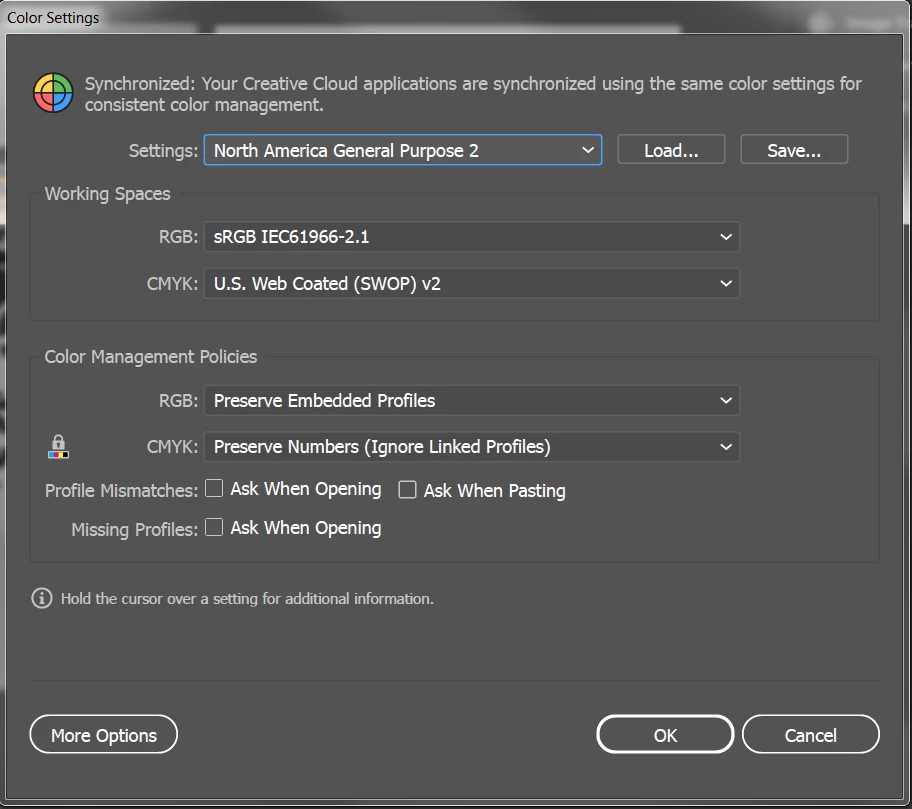

Ton Frederiks
May 28, 2020 11:08 PM UTC
How is your color management setup?
Illustrator only changes CMYK values when you convert between differen color profiles, RGB > CMYK, but also CMYK > CMYK.
May 28, 2020 11:13 PM UTC
Here are my color settings. I don't ever change them and rarely have this problem. Most times I can fix it by creating a new file or restarting illustrator, but this file is being stubborn.
