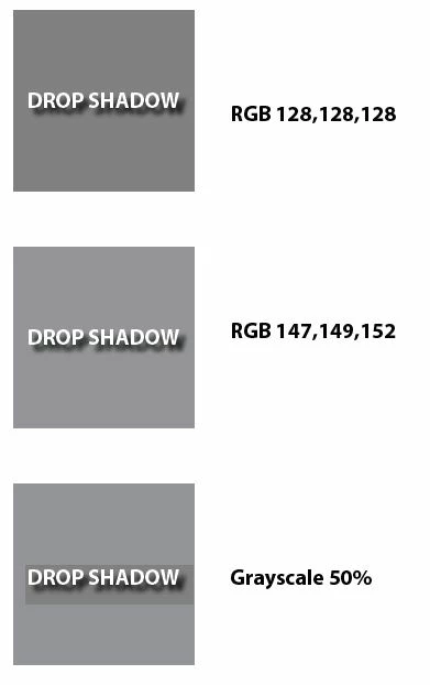

I thought that when you select an object the color palette would show you exactly the color you set -- and would show the color's original colorspace.  This doesn't seem to be happening though.
Please see the linked file below.
Open the Color Palette.
Select the top gray box.  It will show RGB 128, 128, 128. (this is correct -- it is how it was originally designated).
Select the middle gray box.  It will show RGB 147, 149, 152 (this was set originally as CMYK)
Select the bottom gray box.  It will show 50% Grayscale (correct -- this is how it was originally created)
No select the top gray box again.  Color palette shows it as a Grayscale value??? Why?
Select the middle gray box -- now it shows RGB again.  Now select the top box... it shows as RGB?  Why is this behavior so inconsistent?

Ok. I see your issue. It is a problem with flattening. PDF/X1-A and PDF/X3 both have to flatten the file for print. PDF/X-4 is considered live... hence you will not see the issue until you flatten (you flatten to go to print). The problem is when you choose just Black (K) you end up  with not enough colors to mix down when it has to raster an area in the flattening process. This makes it look different from the original background. You need it to be CMYK. You may only be using only the K channel in the original color, but having CMYK adds CMY to the mix down.

Thank you for your answer. While I'm definitely not an AI expert, most of what you said, I already know.
But I'm still not quite clear.  The top and bottom squares are not the exact same color.  One was set up as an RGB and the other was set up as a Grayscale.  So it doesn't seem that they should not show up as identical in the color swatch.
I know they are not the same color (and this somewhat relates back to the other thread where you were involved) because if I save a PDF X-3, the transparency shows up differently (as an error with the Grayscale one).  If I had to debug a file (such as to fix transparency issues as shown below), how would I know that the two colors were different if the swatch shows them as identical?  Hopefully what I'm asking make sense.

Top: Done correctly. Your document color mode and color palette match.
Middle: Incorrect. You entered CMYK values into a RGB document.
Bottom:  Would not recommend. For color constancy enter your values as RGB when in document color mode RGB.
If you enter CMYK numbers in to an RGB document, and you click off the items, then click back on it you will notice your CMYK numbers change. This is because Illustrator converts what you entered as CMYK to their perceived RGB equivalent. RGB and CMYK are 2 different color spaces, and all of as at fruit believe the numbers should go back and forth. Does not work this way as each colorspace  has a differ color gamut.
