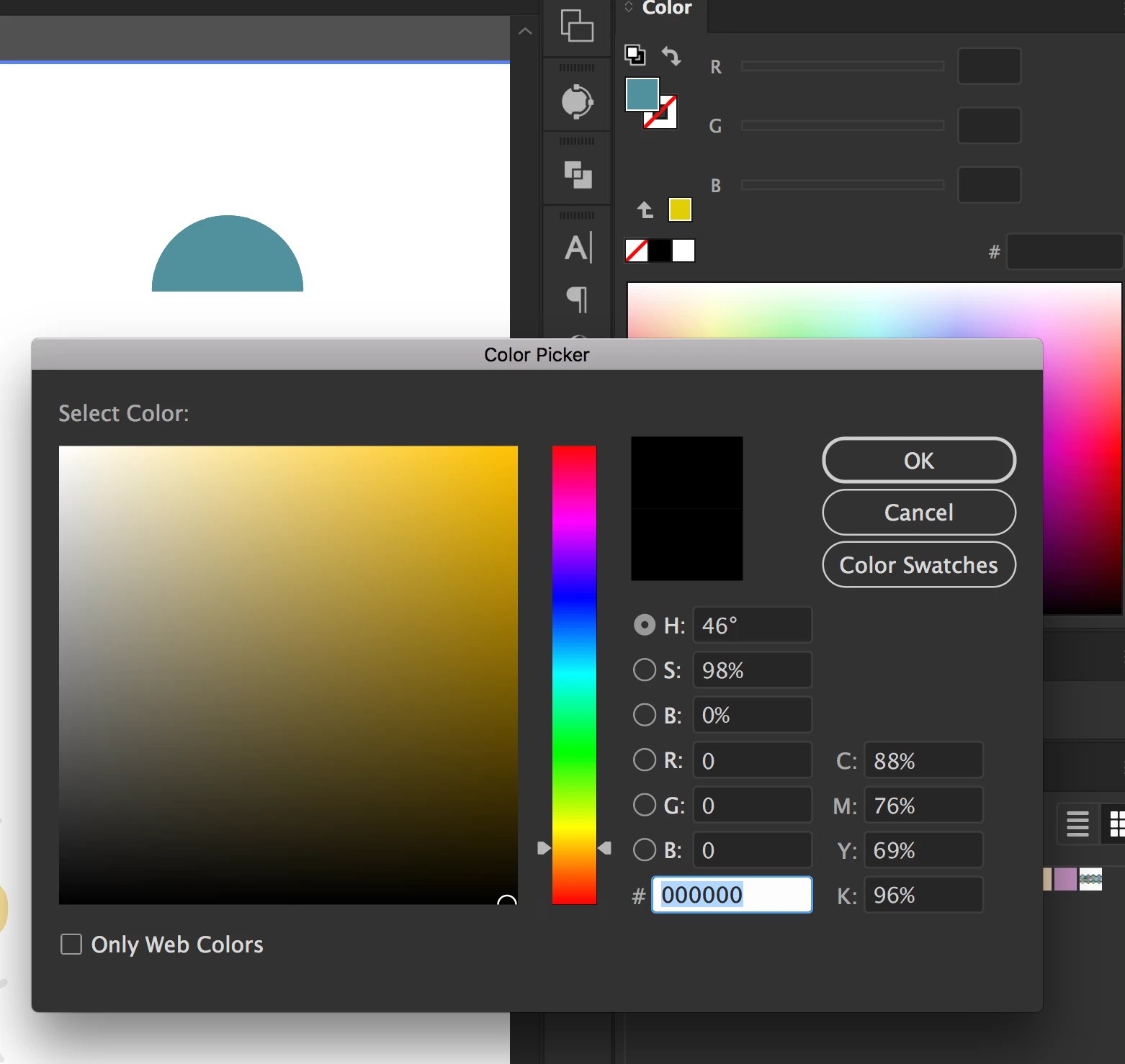

Hi - I hope I explain this right.
I placed a picture into an ai document
I then create a square, selected it and colored it by using the eye dropper tool to choose the color from the image I just placed into the document.
I then selected this box and moved it into the swatch panel.

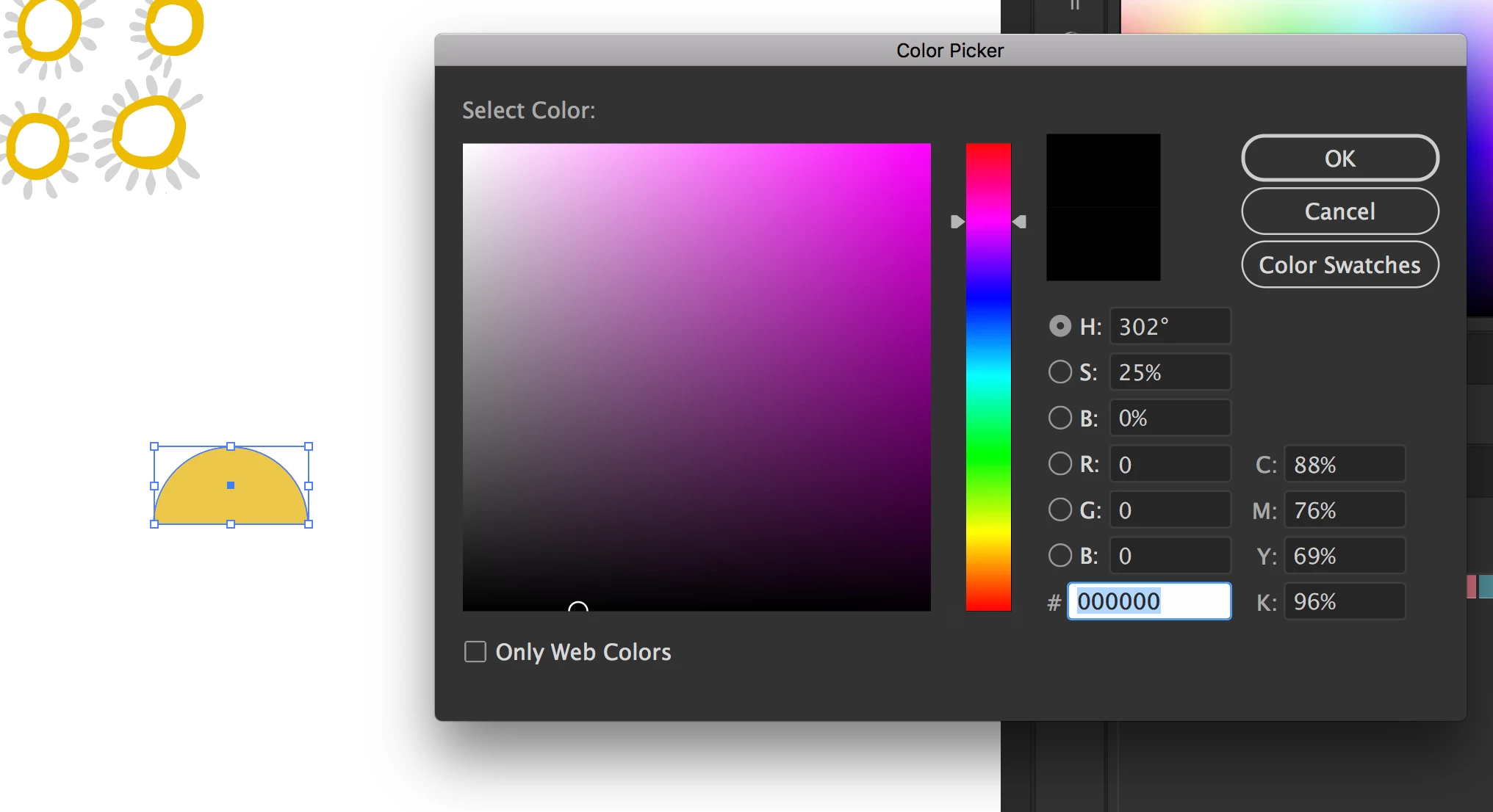

Then I drew another shape and selected it and colored it with the new color swatch I just made.
When I click on this new image, the color picker menu shows either #000000 for the color and when looking at the RGB section it is empty.
When I first use the color picker and fill the first square, the color registers in the color picker section with hex # and everything. It is only after I make it into a swatch does it not register any numbers. Is it suppose to be like this? I even tried flattening in case there were gradients, but it doesn't make a difference. and the images I placed are photos.
Any thoughts?
Thank you.

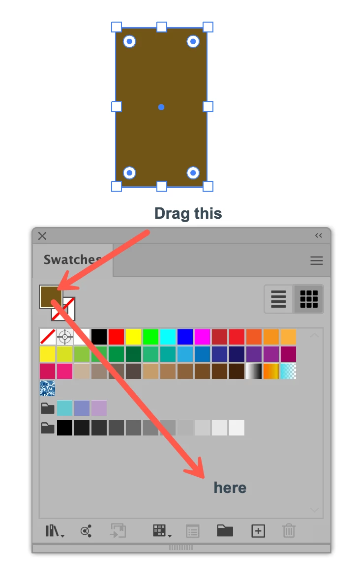

tromboniator
August 1, 2020
By dragging the colored rectangle into the Swatches panel you have created a pattern swatch rather than a color swatch.
Instead, with the correctly-colored rectangle selected, drag the color from the Fill indicator (the correct name escapes me) at the top of the Swatches panel into the main body of the panel. This will generate a color swatch.
