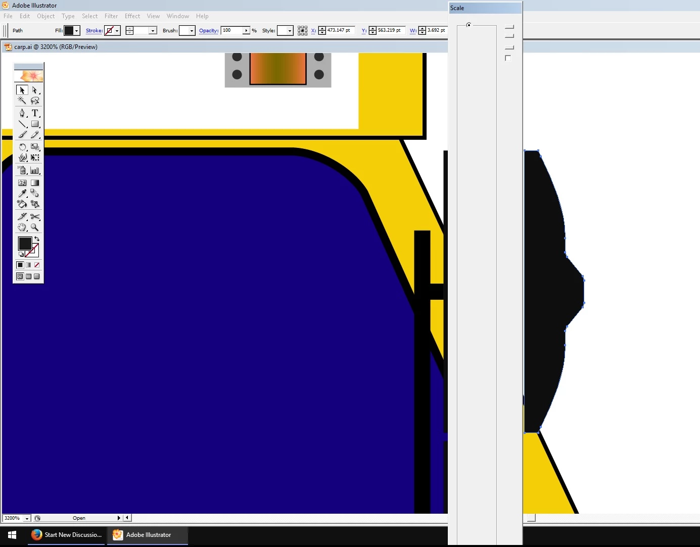

I opened up Illustrator CS2 to find a strange problem I cannot resolve. The dialogue boxes to do most things are not showing up properly. They're missing text, and they're being stretched vertically more than the size of the screen. Here is a screen shot of the dialogue box for "Scale". I've tried many of the other tools, and the dialogue boxes are showing up the same way.
Has anyone else experienced this, and how do I fix it? Thanks.

Bill Silbert
September 2, 2017
This is something that has been reported quite frequently lately. I would guess that you are trying to run Illustrator CS2 on Windows 10. It would seem that the latest update for Windows 10 is becoming an "old version of Illustrator killer". As far as I can tell deleting preferences and all of the usual ways of fixing a corrupt program haven't been able to fix this. It's like what happens to us all eventually. The ravages of time catch up to us. In order to run an old program you must keep your operating system contemporary to it. If you want the latest and greatest OS then the price of that is installing the latest versions of the software to ensure compatibility.
