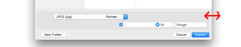

I updated to the new Mac OS Sierra and when I went back into illustrator I first had to download the java update, but then when I went to save my files the Format section in Export is grayed out. It will not let me save individual art boards to PNG or JPEG. It will now only let me save individual art boards when I go through Save As. How do I fix this? I don't want to have to create new documents for every art board!
    Correct answer ad48802675
    Hi!
    I have the same issue for Ai CS6 after update.
    The solution is pretty simple: just scale the width of your export window to minimum, and the box for ticking artboards becomes active and you can select the range.
    Hope this will help!

    Hi!
