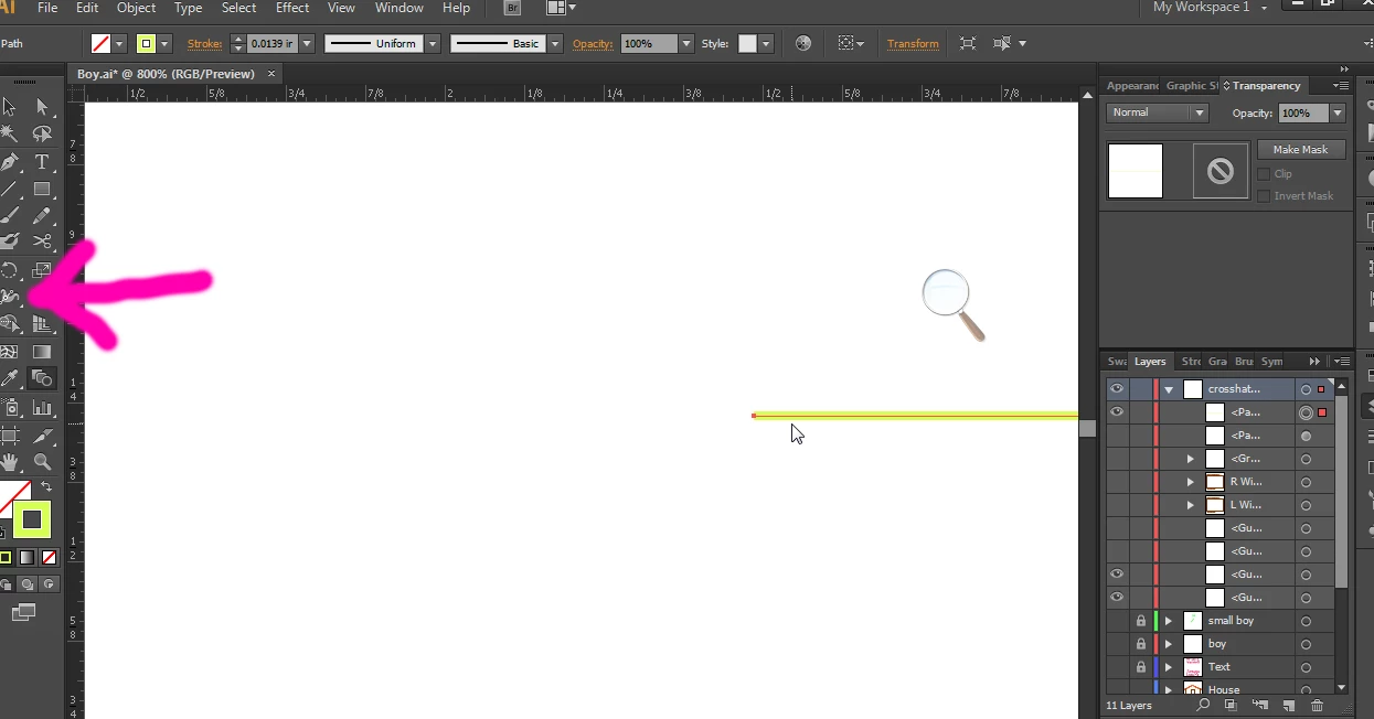

OK, to start; I'm using CS6 local install
Windows 7
Intel I7 processor
with 16 GB of RAM.
The Width tool will not work except intermittently. No rhyme or reason.
I draw a straight line with the Pen tool, then switch to the Selection tool, "black arrow".
I then select the line and change to the Width tool and I am unable to do anything with it.
I get that weird little cursor but it will not recognize the line in any fashion at all.
I click and drag every way I can; with various modifier keys or just click and drag. Nothing I've tried will work.
I read several of the threads dealing with the same issue and I've tried all the suggestions like checking that I'm using the Basic brush, and making certain that the stroke is aligned center.Nothing works .
I've already burned up 3 or four hours.

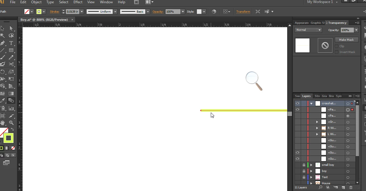

Sorry, I had the Width tool selected but when I try to capture it with Snagit it goes back to the Selection tool.
in any event, I was trying to show that the little white handles don't  show up when I hover over it.

    Width tool is that one:
