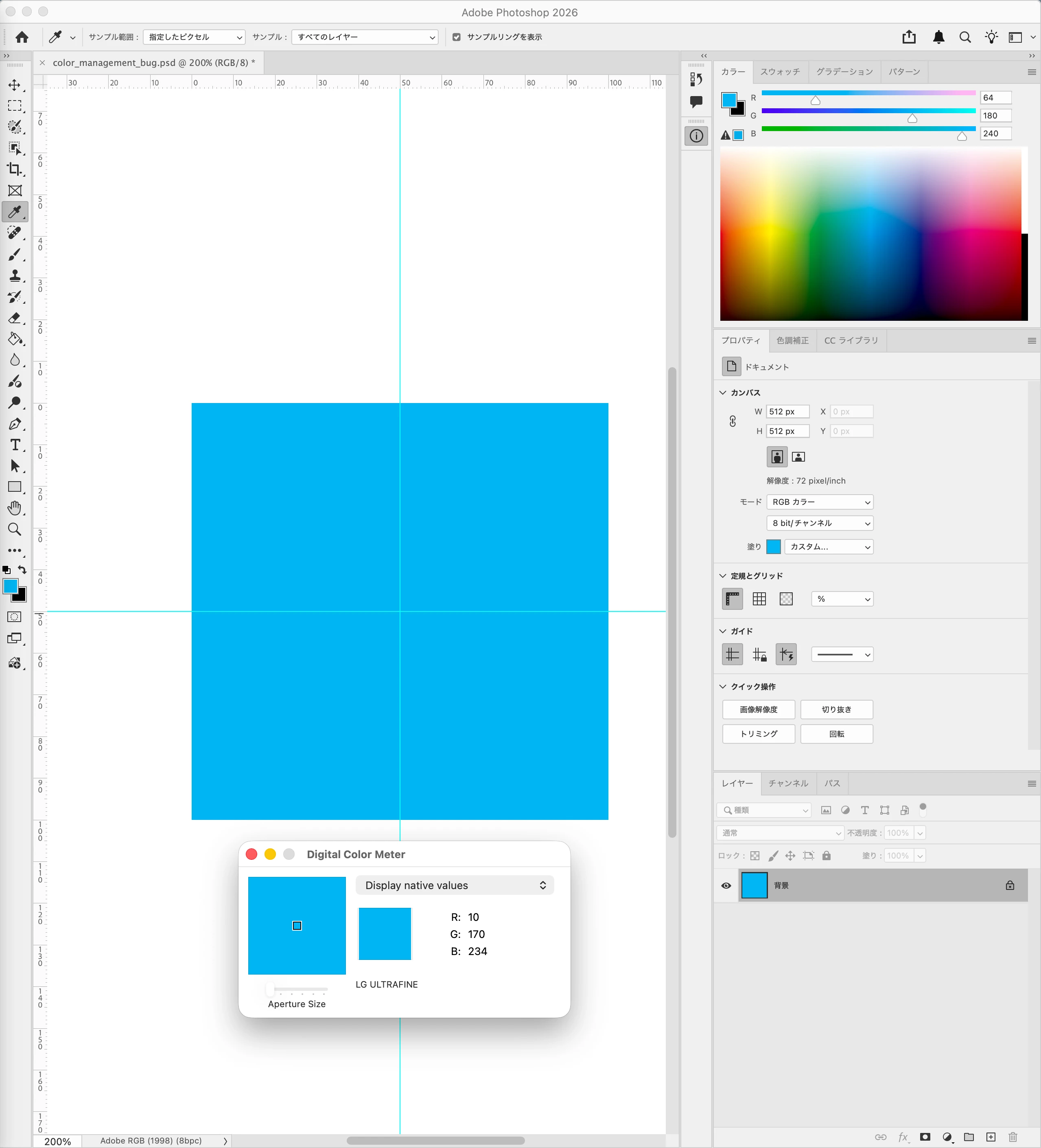

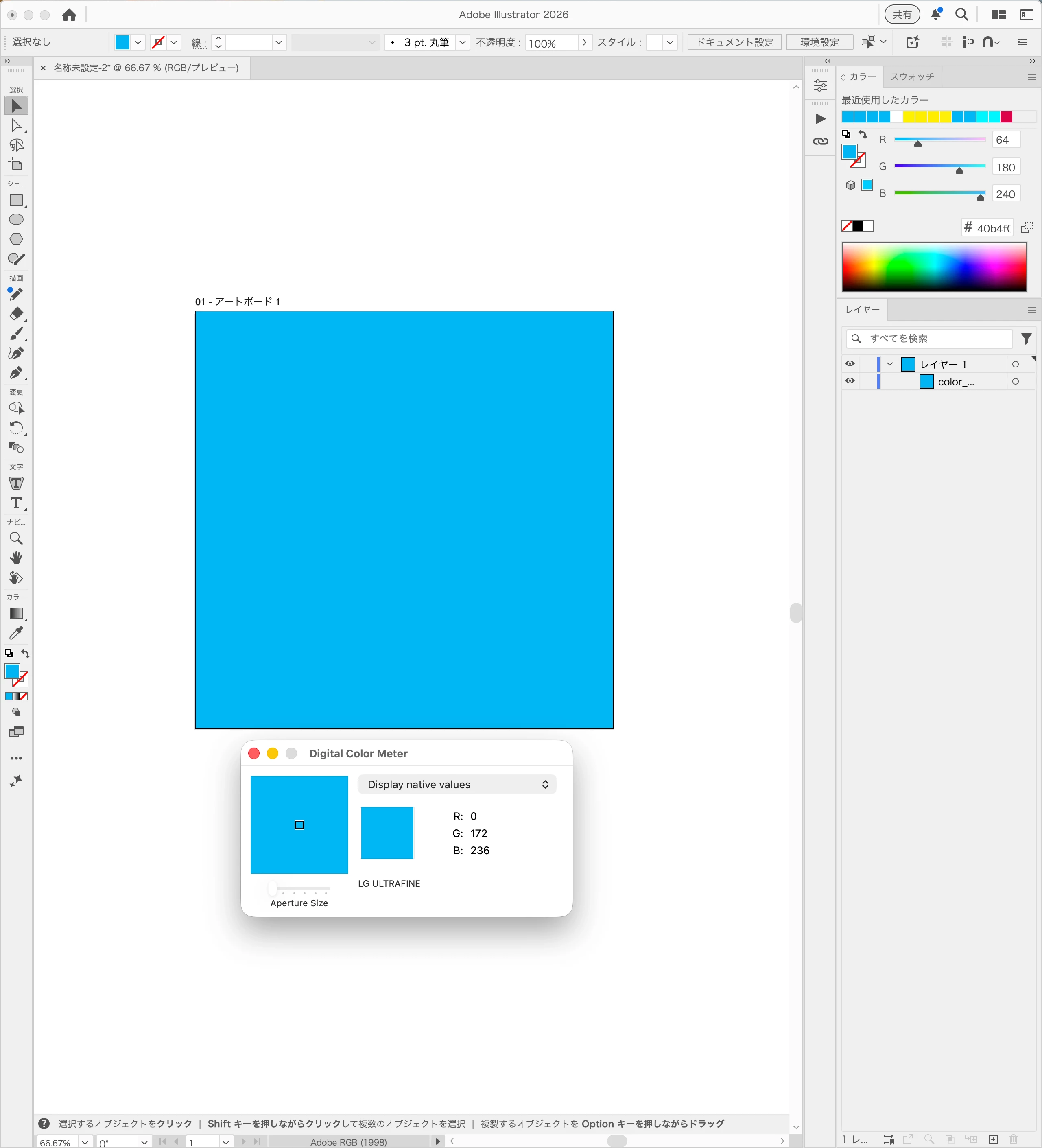

Illustrator 2026 displays the colors of a placed PSD file differently than Photoshop.
I checked the software settings in the screenshots below: both files use the Adobe RGB (1998) color profile, and the color management settings have been synchronized via Adobe Bridge. I’ve also attached a minimal reproduction file. I hope this bug can be fixed soon.

​@Kaoru Yamaoka there is a difference between linked files and embedded files.
When files are placed linked, the color picker uses the image preview for the color values.
When files are embedded, the real values from the image are used.
This is a problem that was solved last year, but has come back unfortunately.

Thank you for pointing it out, it solved my question about the Illustrator Eyedropper bug. However, I’m still seeing incorrect color values even when the PSD is embedded in the Illustrator file: Illustrator displays the colors differently from Photoshop. (The Eyedropper shown in the screenshots is the macOS Digital Color Meter, not the Illustrator Eyedropper.)
Ton Frederiks
January 28, 2026
Good to hear that helped. The eyedropper from MacOS shows the screen preview values and not the real Photoshop numbers. If you want the correct values, embed the files and use the Illustrator eyedropper.
