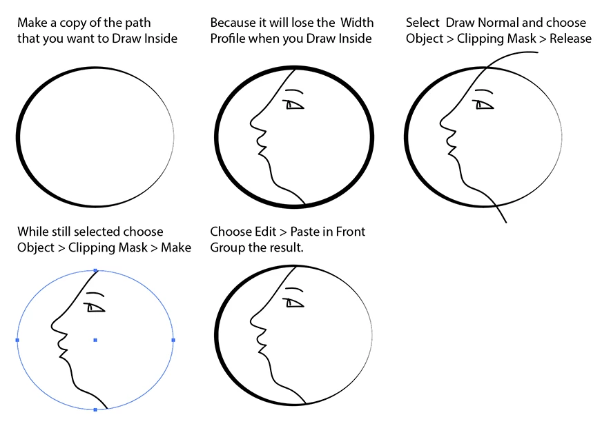

I am using draw inside mode to shade but if I have a stroke profile or have used the width tool to adjust the stroke it reverts it back to a basic profile. Is there any way to keep stroke profiles using draw inside mode?
Correct answer Ton Frederiks
It loses the width profile and you can make a feature request here:
https://illustrator.uservoice.com
But you can use this workaround.
Ton Frederiks
Ton FrederiksCommunity ExpertCorrect answer
April 6, 2020
