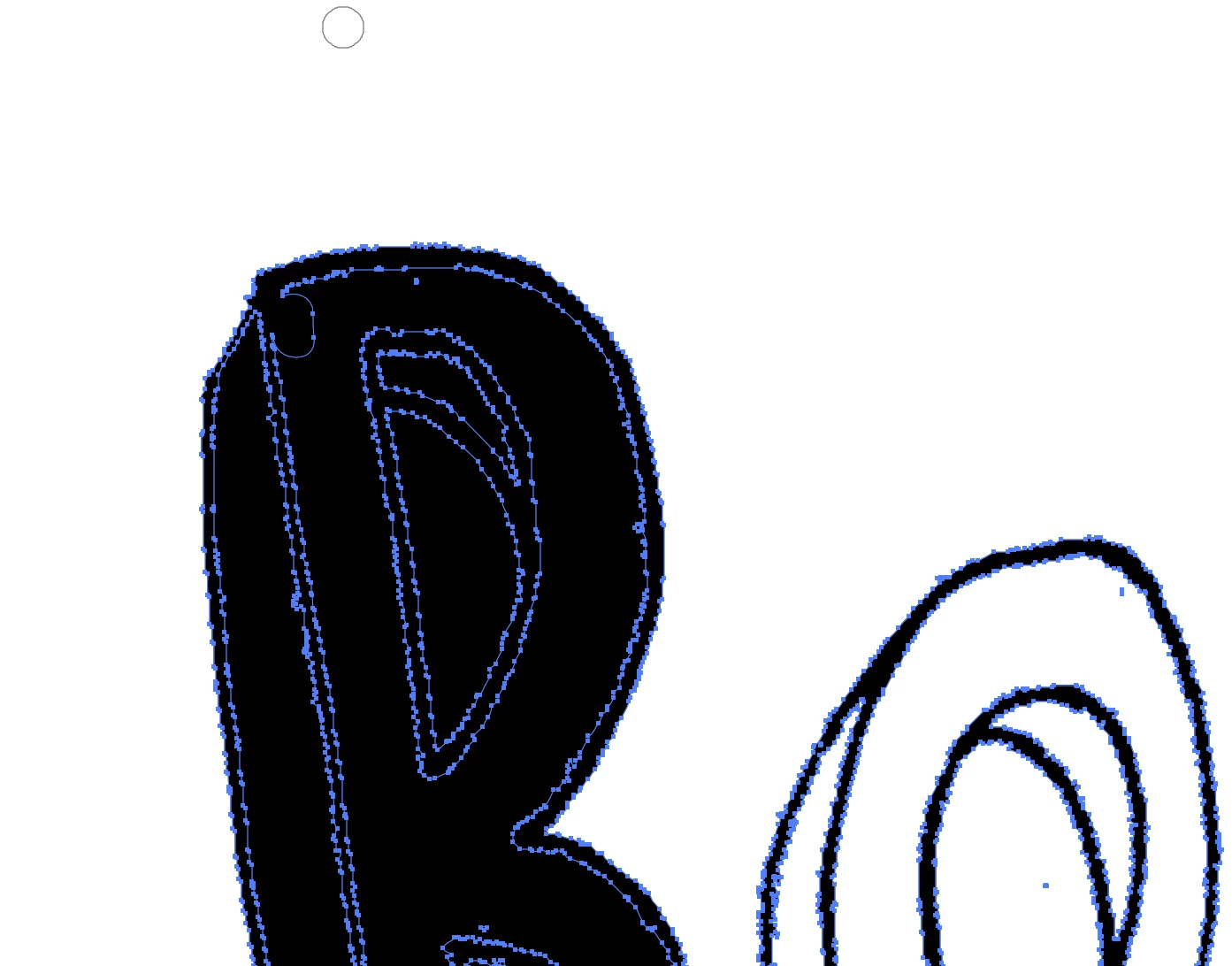

I'm trying to erase some rough parts of a sketch I scanned in and auto-traced in Illustrator, but whenever I go to erase them, it inverts the whole shape as if I deleted the fill, but I didn't. There are no strokes, it's just a vector traced object with points. After I erase the parts, I have to go into Pathfinder and hit the 'Exclude' option... Any suggestions why it's doing this?

Could you possibly be using the path eraser tool (within the shaper tool) , instead of the eraser tool (SHIFT E).
Appears you are using the correct eraser tool and a compound path is being broken. I suspect this is coming from the image trace.
As a test can you try on an outlined font and let us know if the problem happens there. Would be good to see you image trace settings, even though in my tests ignore white and overlapping method did not make a difference.
You can also try resetting your prefs if a tool in not functioning normally.

Not sure what exactly you are trying to erace there. Please sho before and after.
