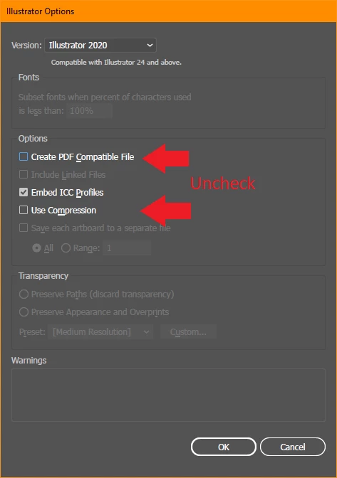

One thing that worked for me was to uncheck the following during the saving process:
"Create PDF Compatible File"
"Use Compression"
While this might not be a permanent solution, it should allow you to save your current document without losing hours of work.
Once saved, you should check for updates and restart your computer.

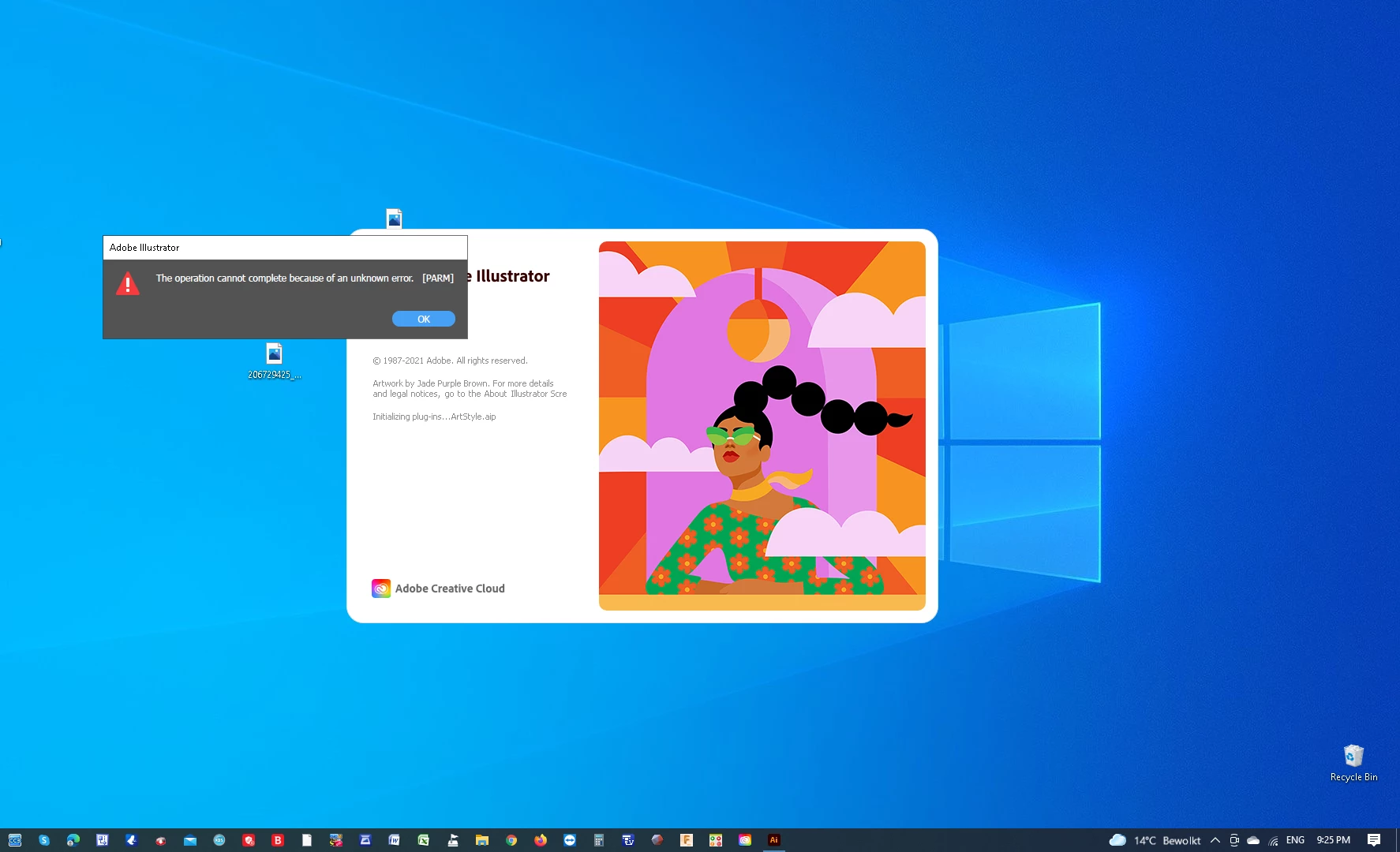

June 30, 2021
Hi
I have an error like in the photo. I can't open Adobe Illustrator, I've try to update my app, but nothing works. Can I uninstall Illustrator and again install? Thanks

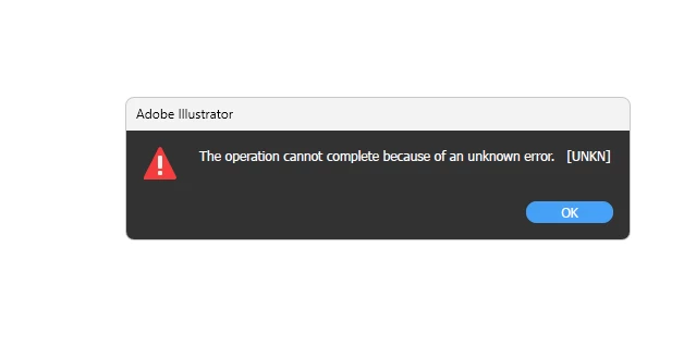

''An unknown error has occurred'' when i try to save files.
Someone can help me?
Thanks
Met1
May 19, 2021
Try saving to a different location.
Try saving to a different version of Illy, or pdf.
What are the file characteristics? is it chock full of images?

February 4, 2021
When I get this problem saving as an .ai file, I uncheck the create pdf compatible file box and it will save it.
February 12, 2021
Thank you! This just happened to me tonight for the first time after saving the same file multiple times. I tried another suggestion to make sure layers were unlocked and visible; that had no impact. This solution (unchecking "Create PDF Compatible File" on save properties) is the only one that worked for me.
Running Illustrator 25.1 (64-bit) on Windows 10 Enterprise.
