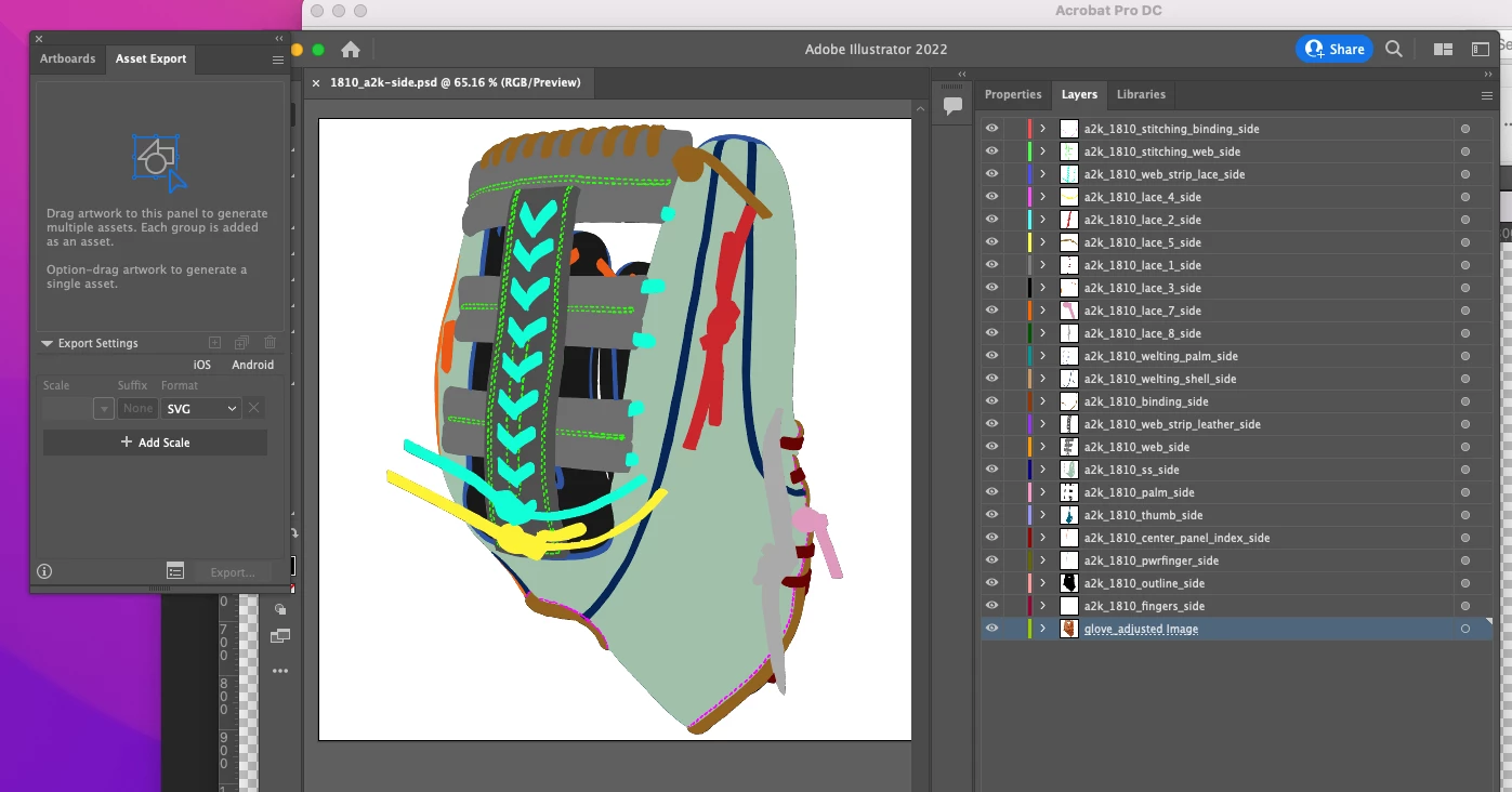

Hi there! Thank you so much for the response. For context, here's what I'm doing...
1) I'm creating shape layers in photoshop (there are about 30 in each of my psd files.)
2) I then open that psd in Illustrator which puts each shape on a separate illustrator layer (see attached screenshot of how my psd looks when it's opened in illustrator).
3) I then grab all of the artwork/layers and drag them into the 'asset export panel' and export all of the layers as SVGs. Which trims each shape (grrr)
My goal is to have have each svg retain it's placement on the original size of the artboard/layer (as it would if I were saving each layer as an SVG.) What I'm trying to avoid having to do a 'save as svg" for each layer (shoot me). 🙂 Any advice on how could do this differently to achieve my goal? I'm using the latest version of Illustrator 2022.
2) I then open that psd in Illustrator. When I do this, each shape layer from the psd gets place on a separate layer (see screenshot).
3) I then grab all of the artwork/layers and drag them into the 'asset export panel' and export all of the layers as SVGs. Which trims each shape (grrr) But i don't see an 'artboard option' during this process as you mentioned in your reply? See screenshot of what my psd looks like when open in Illustrator.
My goal is to have have each svg retain it's placement on the original size of the artboard/layer (as it would if I were saving each layer as an SVG.) I'm using the latest version of Illustrator 2022.

April 26, 2022
You could try this script with the Trim Edges option unchecked:
https://gist.github.com/TomByrne/7816376#file-multiexporter-jsx
