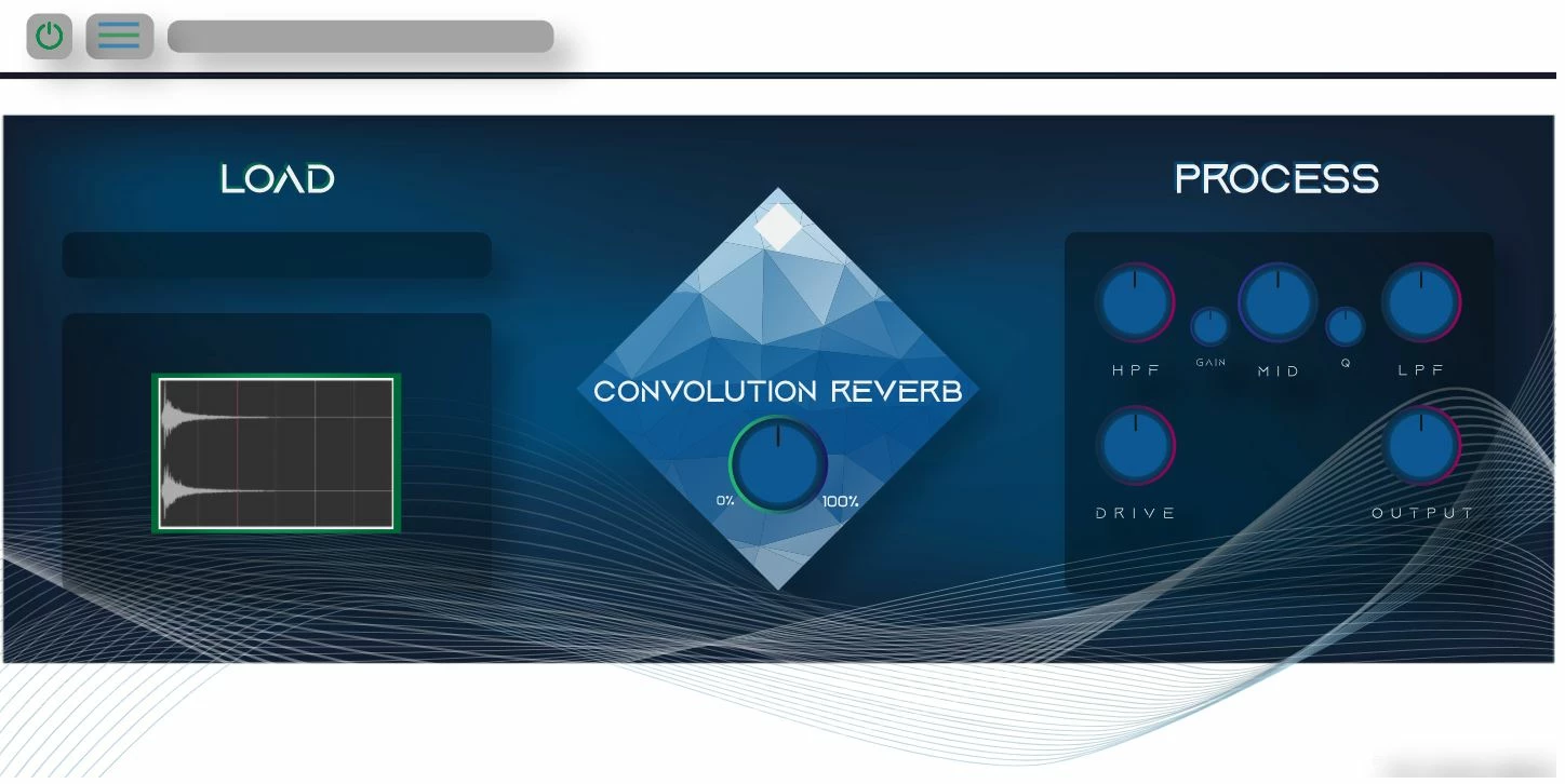

Hello Everyone,

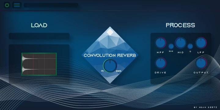

For some reason, my svg file is not exporting correctly when I am using illustrator. I have attached a PNG of what it is supposed to look like, a JPEG of my export settings, and my messed up SVG file. Any help will be greatly appreciated as I have been stuck on this for quite some time. This top image is what the svg looks like exported, the middle image is what it is supposed to look like and then the bottom is the export settings.
Best,
Noah

The long and short of it likely is that your many gradinets and the wavy line expand the pixel data and cannot be expressed in a way that they retain the correct order and cropping inside the SVG. Exporting this as SVG doesn't really make a lot of sense in the first place because of that. It will simply end up being a ton of PNG data in an SVG wrapper with most vector data and editability lost. Anyway, the long answer is that you may need to spend a ton of time re-ordering your layers and objects, expanding appearances and likely forego stuff like drop shadows that would later be expressed parametrically as SVG filters or CSS properties. Again, your stuff doesn't lend itself for an SVG and will need a lot of attention to even get some editability.
