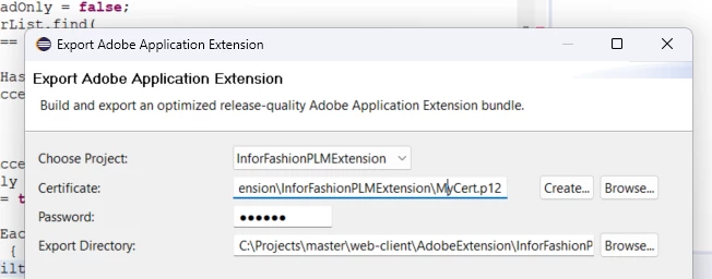

This is how we created the installer:
1. We exported the codes via Export Adobe Application Extension(zxp)
2. Install the zxp via MAC extension manager. It will install the plugin to Illustrator
3. Under the adobe/CEP/Extensions folder in MAC, you will see the installed plugin codes.
4. We will then copy the plugin codes, set the permission to read and write.
5. Then we run this to MAC terminal and it will create the .pkg file: pkgbuild --root I**F**PLMExtension install.pkg --install-location /Library/Application/Support/Adobe/CEP/extensions/I**F**PLMExtension/ --identifier com.i**.I**F**PLMExtension
And that's it.
