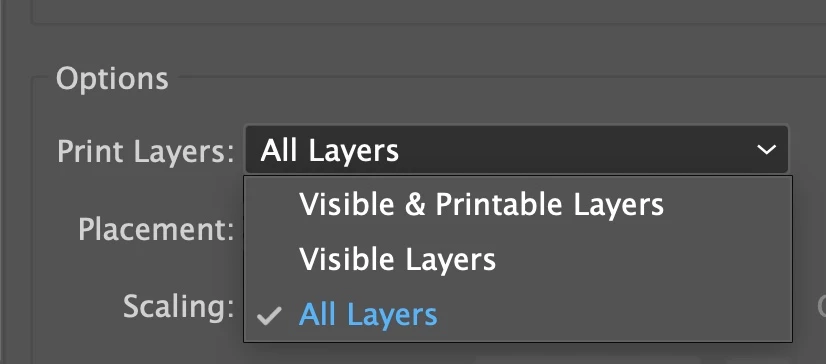

Where does it look that way in Illustrator or Acrobat or both? What happens if you try another preset?
Would this happen if one of the layers was off. This setting affects the making of PDFs not just print.
July 10, 2023
Thanks Mike, I've selected "all layers".
So I export it and view in acrobat. On desktop it looks fine, but when I view on mobile it looks whitewashed...don't know if I can trust the desktop view enough to send to print?
