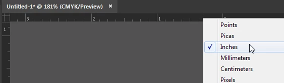

    I would suggest that you add a couple of horizontal ruler guides. If the rulers aren't showing, choose View > Show Rulers. If the units are not inches, right-click inside a ruler and choose inches.
