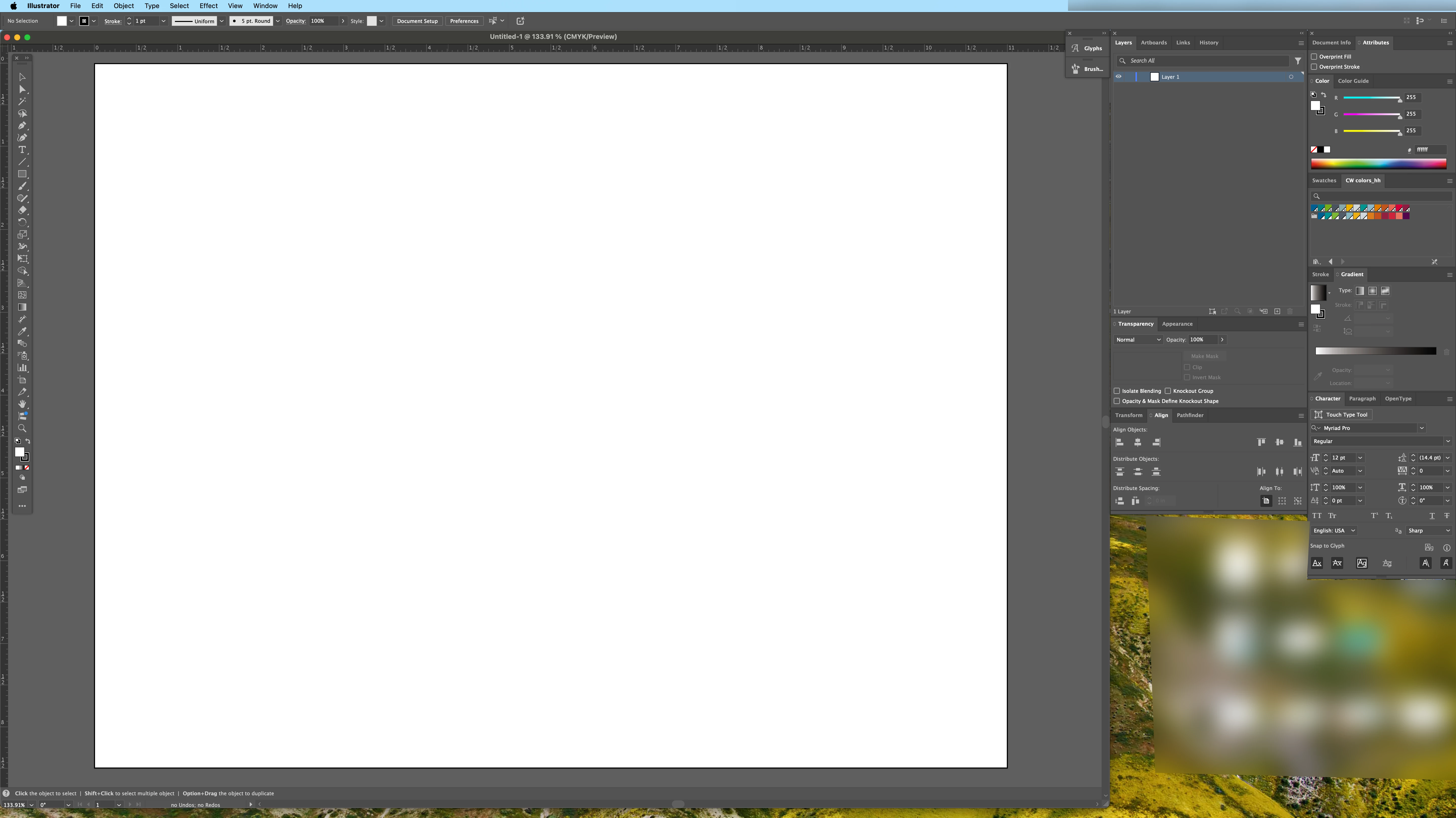

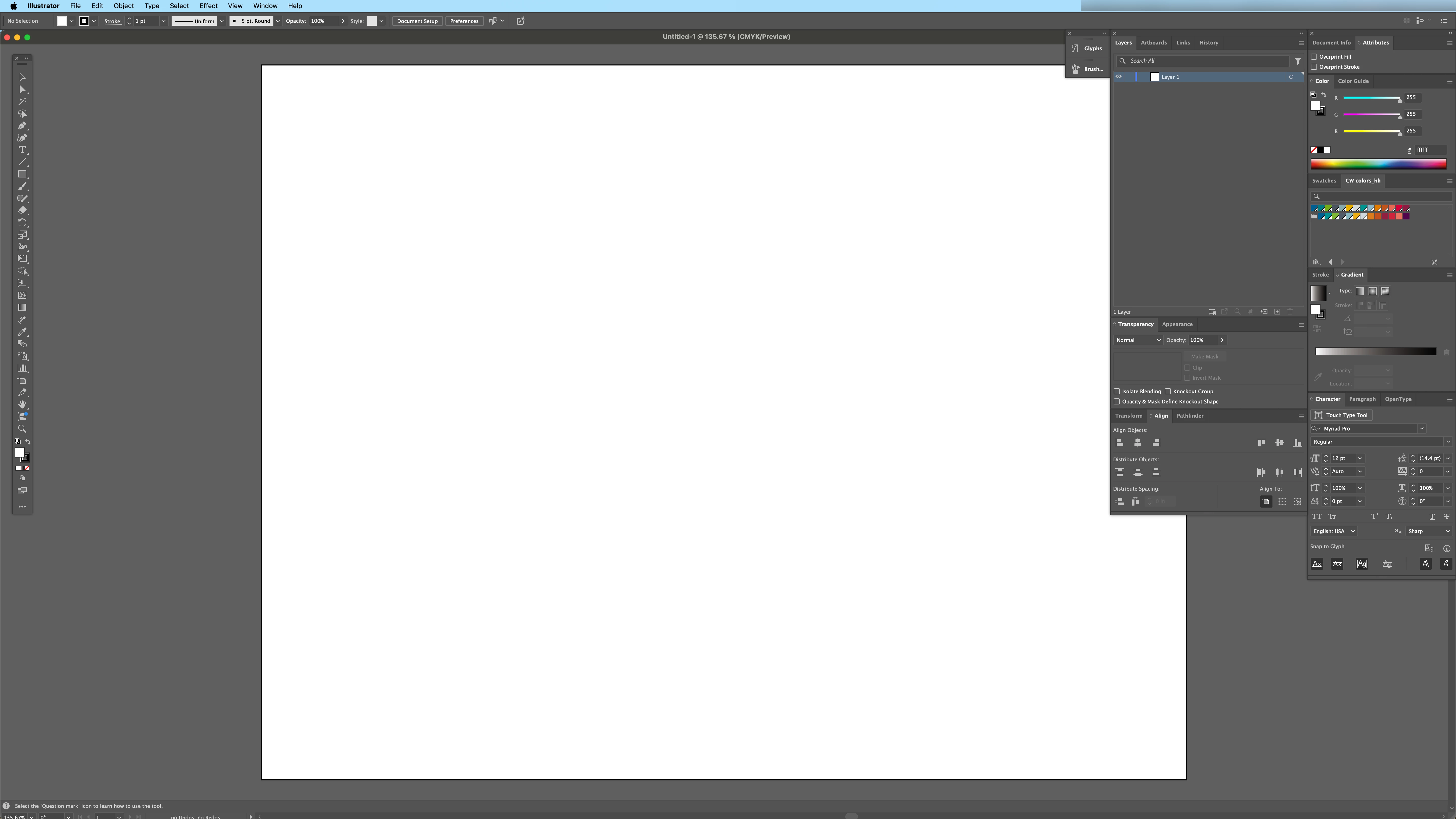

Well, this morning when I make a new file, Illustrator opens the window full screen and without the ruler visible.  Illustrator used to remember the last New window state. I am now having to resize it, set the zoom, and show the ruler EVERY TIME I make a new file. Please fix!!

Hi, Abhishek. Thank you for your reply. I am running the most current version, 29.7.1 on Mac Sequioa 15.6.1. Resetting the preferences did not affect how a new file opens--they all open full screen no matter how I resize and then close one.
I thought the Document Profile you mentioned might be a usable work around--as you have to select a profile from the drop-down in the open dialog box--but it still opens full screen and not at the window size and postion it was when I defined that document profile or last closed a new file. I am pretty sure that AI used to remember what size and postion to open a new docuemnt as, until now.
BTW, InDesign has had this horrible behviour for a number of versions now, but I recently found a script and modified it to force new (and exisiting)  files to open at my desired window size and postion. Sometimes I have to run the script manually, but most of the time it works. I might have to find a similar solution for Illustrator, now. Sigh.
