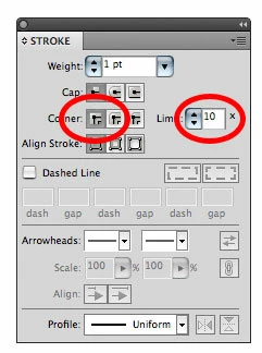

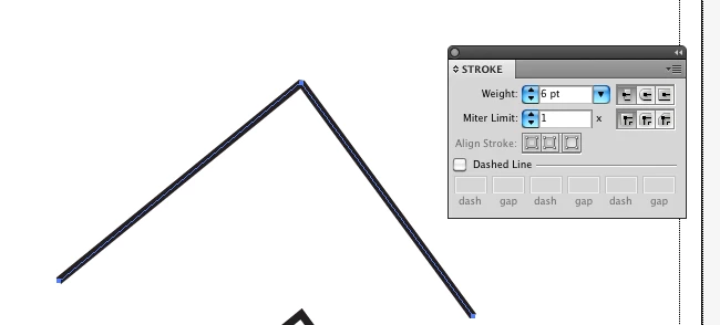

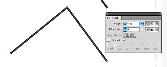

    Is this what you are talking about? The key is the miter limit setting in the Stroke panel
    _scott__
    July 26, 2011
    With the art selected, make certain the corner is set to squared, and then adjust the miter limit until you're happy.
    July 26, 2011
    Ahh right, that worked. Thanks a lot guys.
