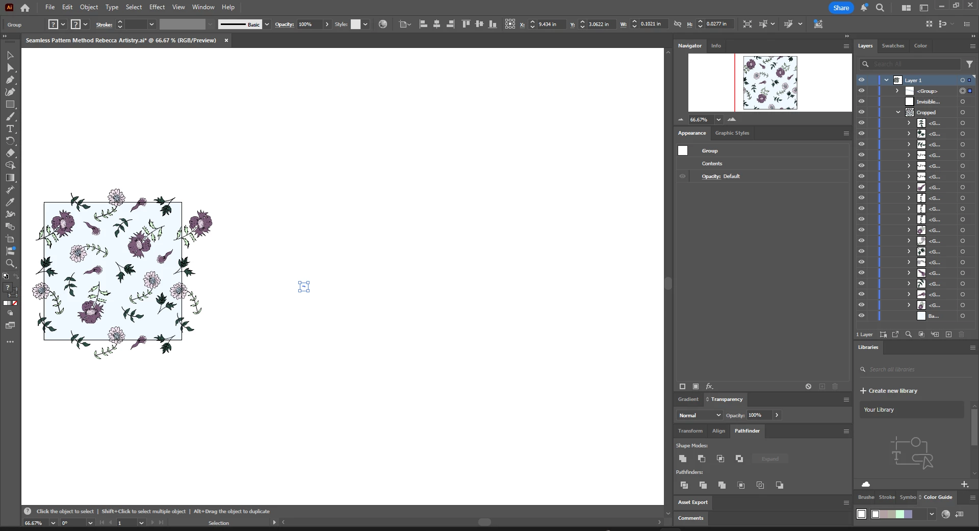

    Hi Monika,
    I am trying to follow a set of instructions in order to create a seamless, repeat pattern. I have created a swatch with this pattern that seems to work fine but is not cropped so the elements overlap the edge as seen in the first image on the left. The instructor suggests making a cropped version to remove all the visible parts of the elements that overlap the edges of the bounding box. As instructed, I re-order my layers to bring the invisible layer (which apparently tells Illustrator to create a repeating pattern 🙂 above the grouped layer in this first image. Then I go to Pathfinder and Crop. I have followed it through half a dozen times. The first time it worked perfectly. So I know I must be doing something wrong but I can't figure out what. Thanks for taking the time to try and assist me. Much appreciated.

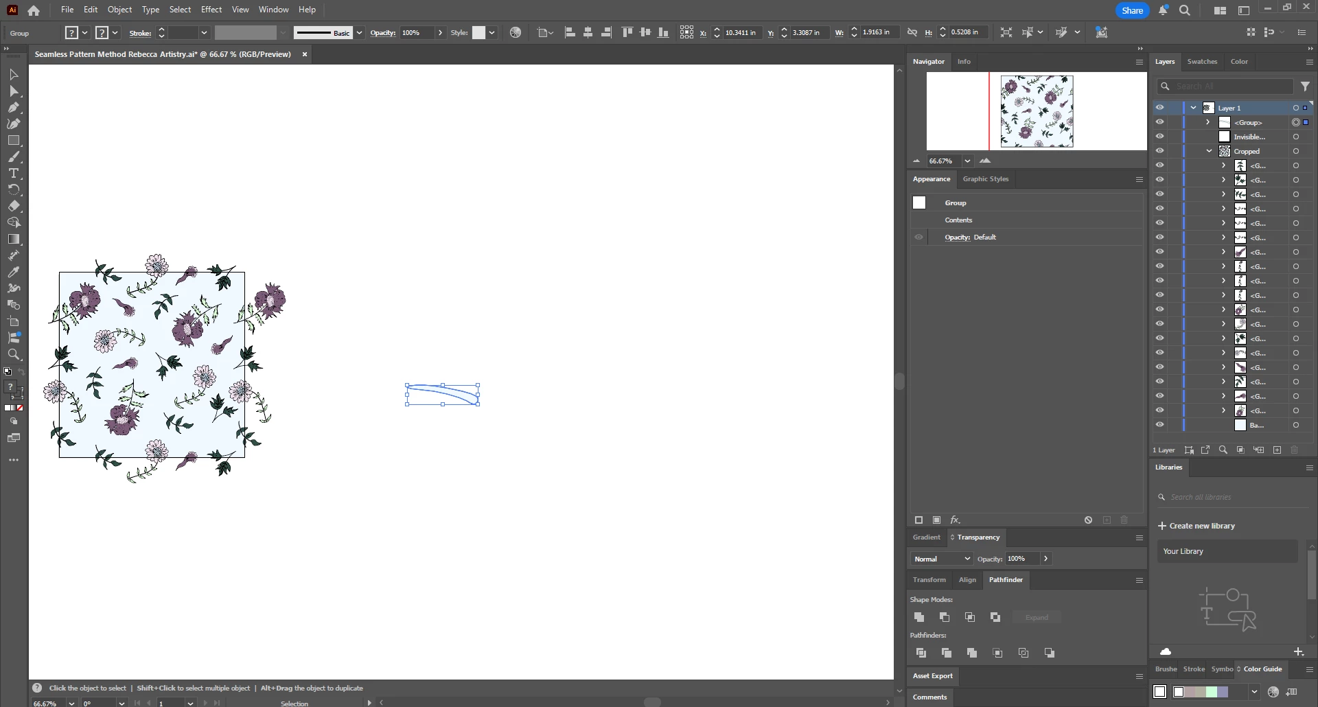

    When I crop this happens...

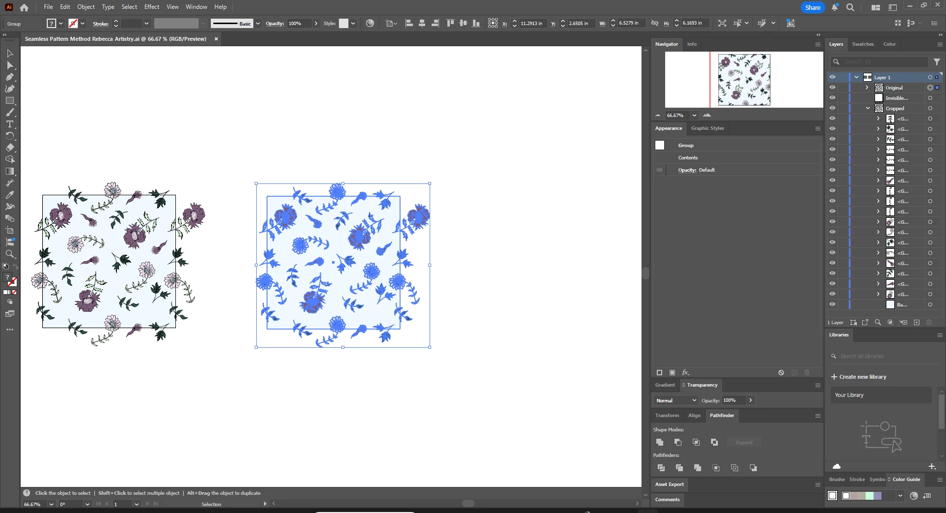

    When I scale that selection up it looks nothing like my original design.
