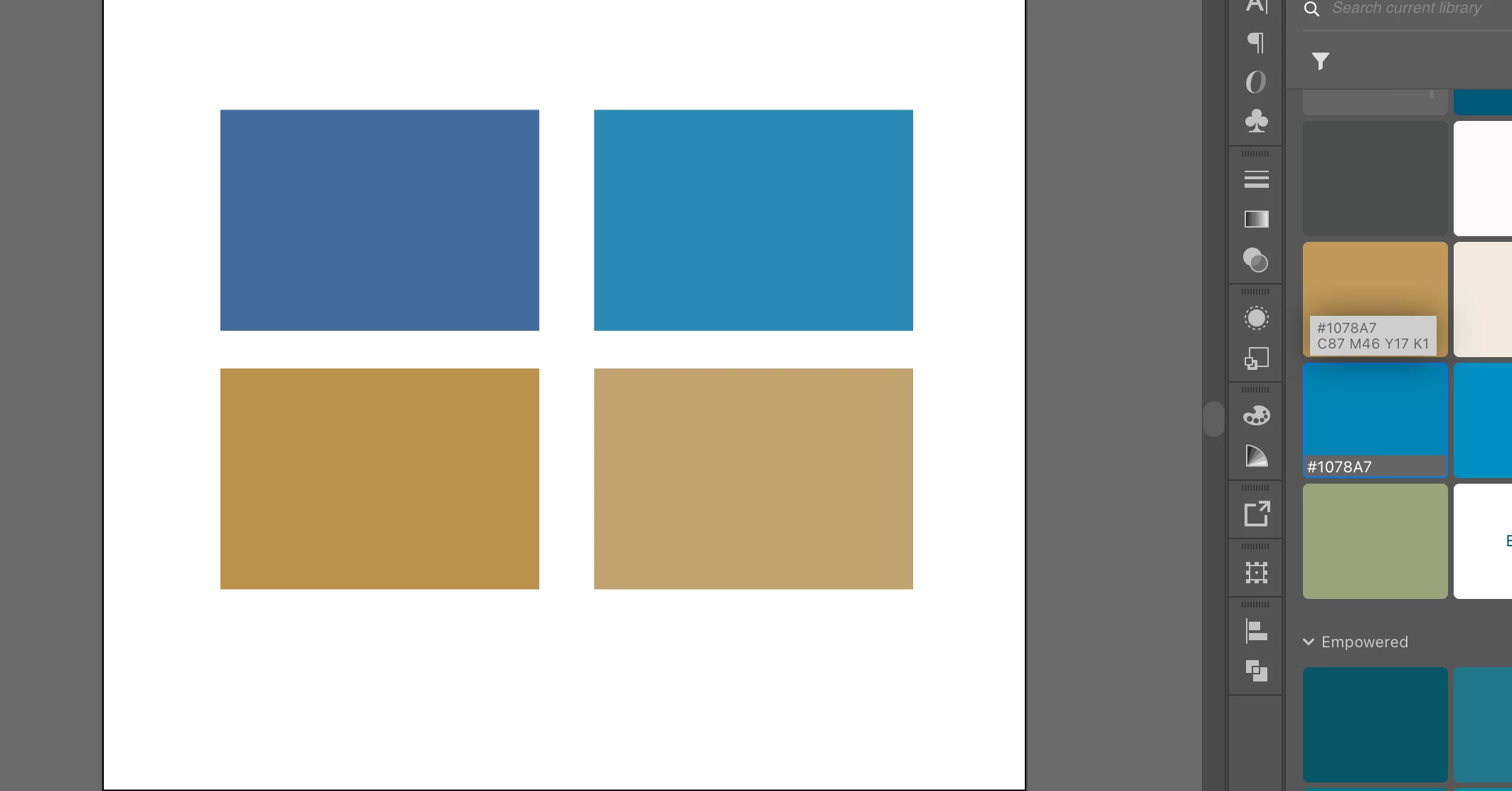

I am having an issue where my colors saved in my libraries have adjusted themselves to different #HEX numbers seemingly at random and differently in both Illustrator or InDesign. Assuming this was a one-time issue caused by an update, I tried to go back and edit the individual colors back to their intended color, and the library again shifts it to a different but similar color. What is happening with my library, and how do I fix it?

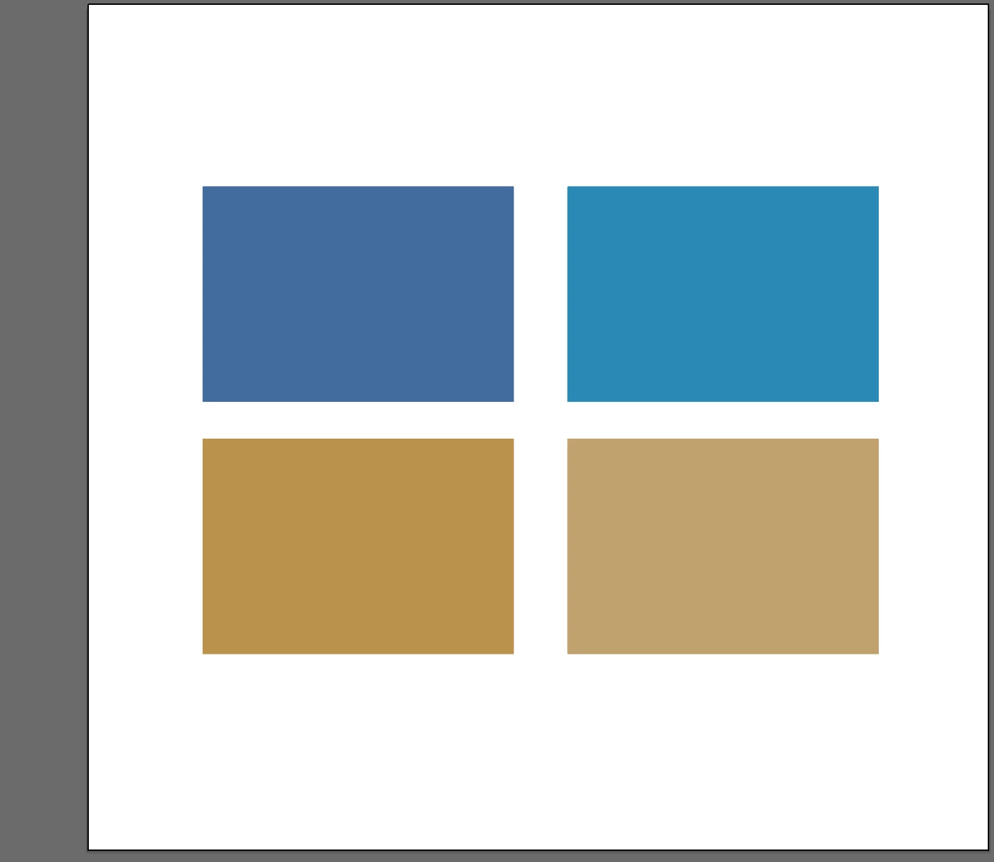

The colors on the right are correct with their colors changed directly via the color selctor menu. The colors on the left were changed via selecting the shape, then selecting the library color.

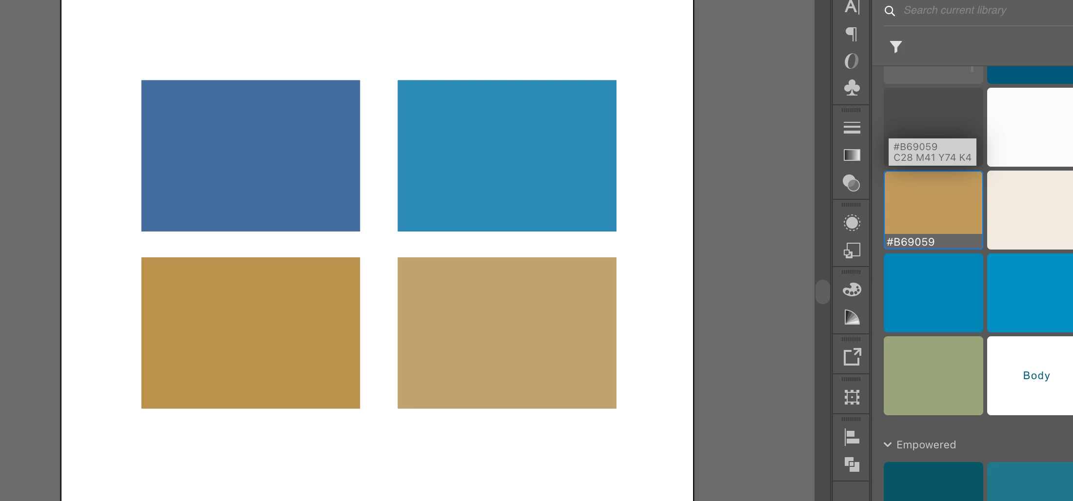

This shows the color that the library thinks this is, and when selected or edited this is the color #HEX the library says it should be.

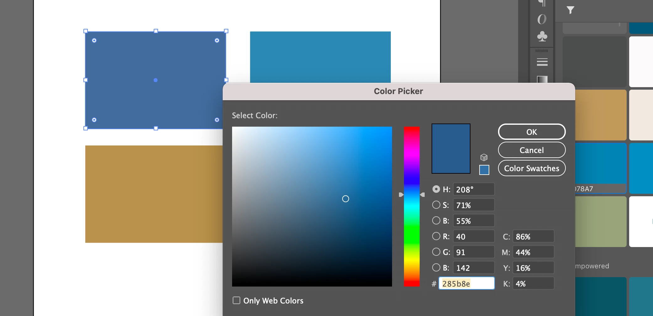

Here is the blue

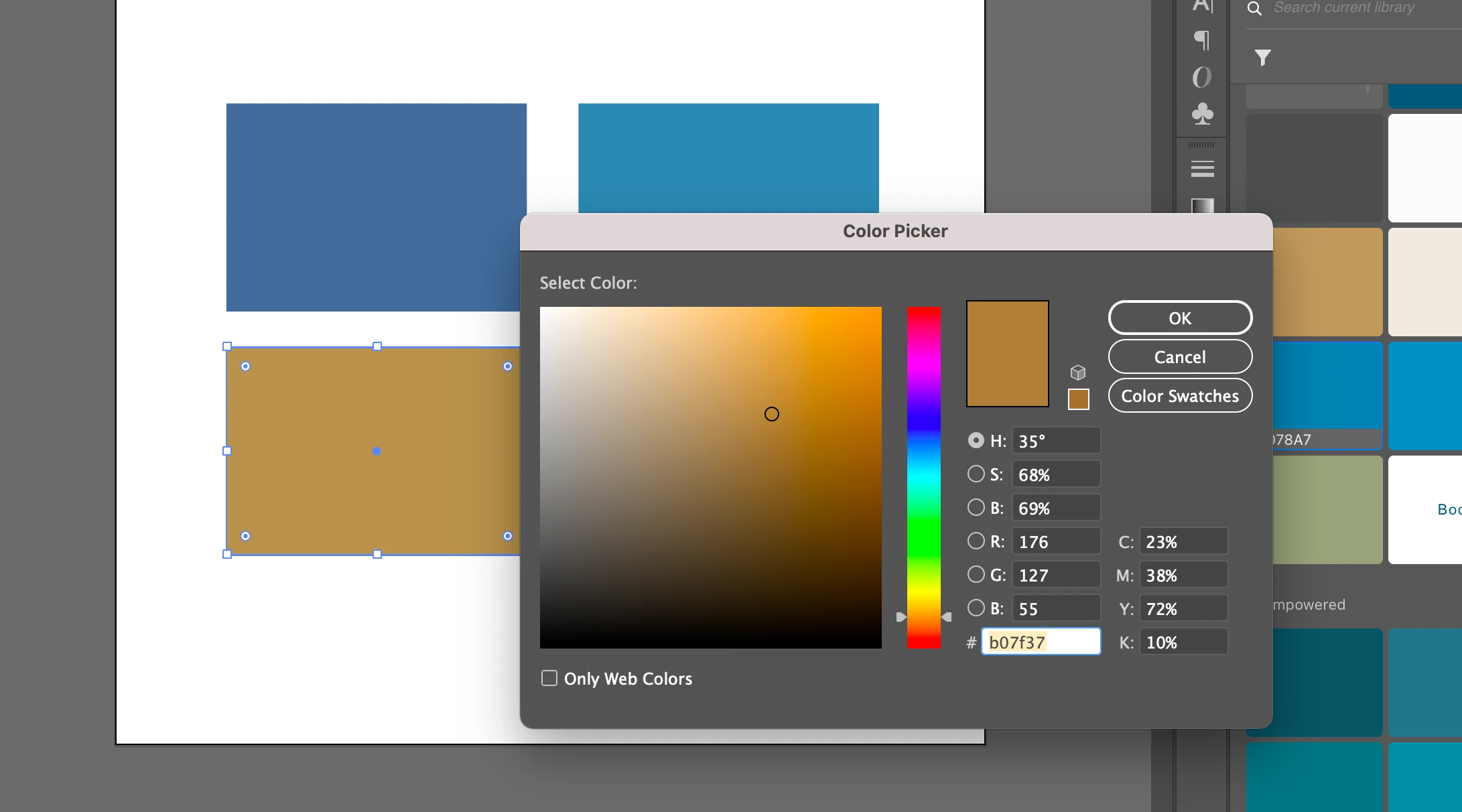

But when a shape is directed to pull the color from the library, it randomly selects a different color instead. Doing this same exercise in InDesign, it will give me a different color instead of the stated color code.
And here is the gold doing the same thing.
