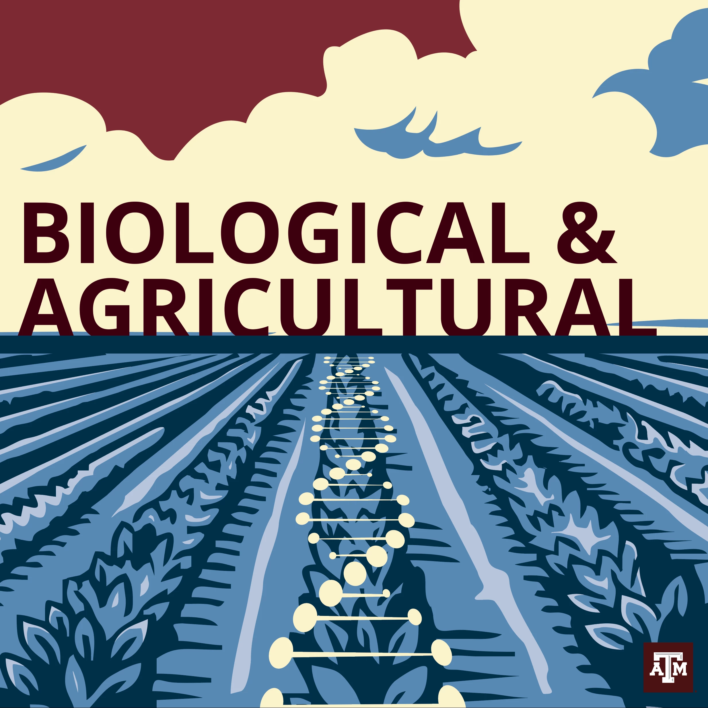

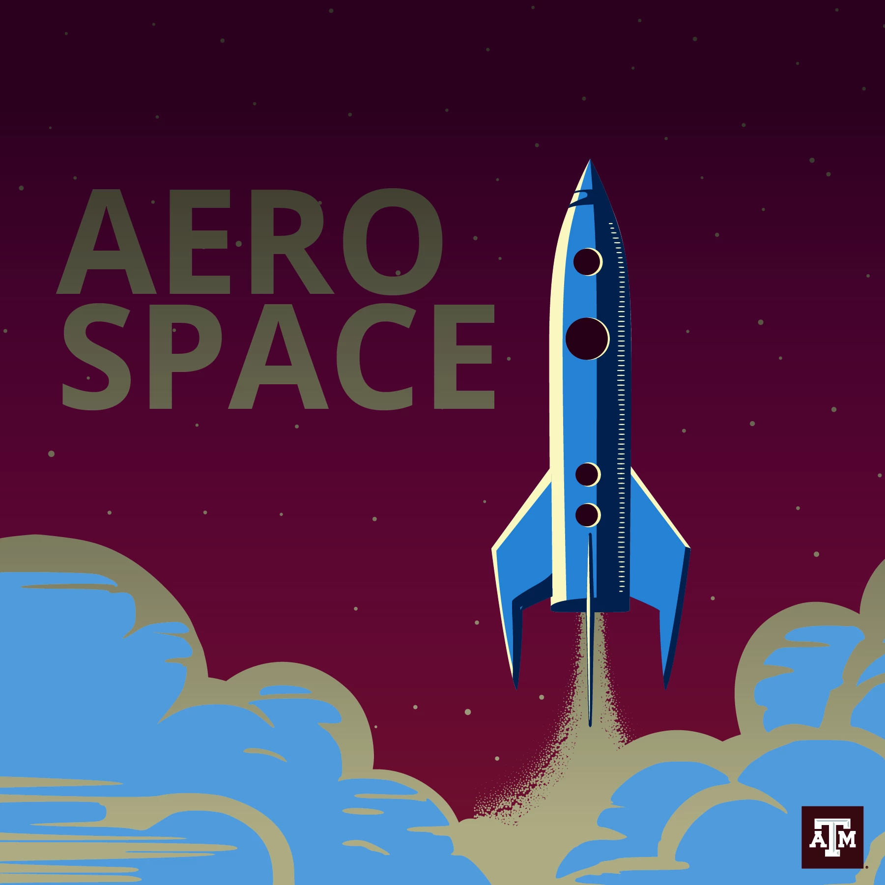

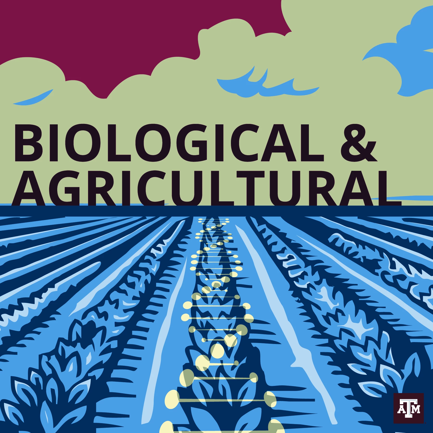

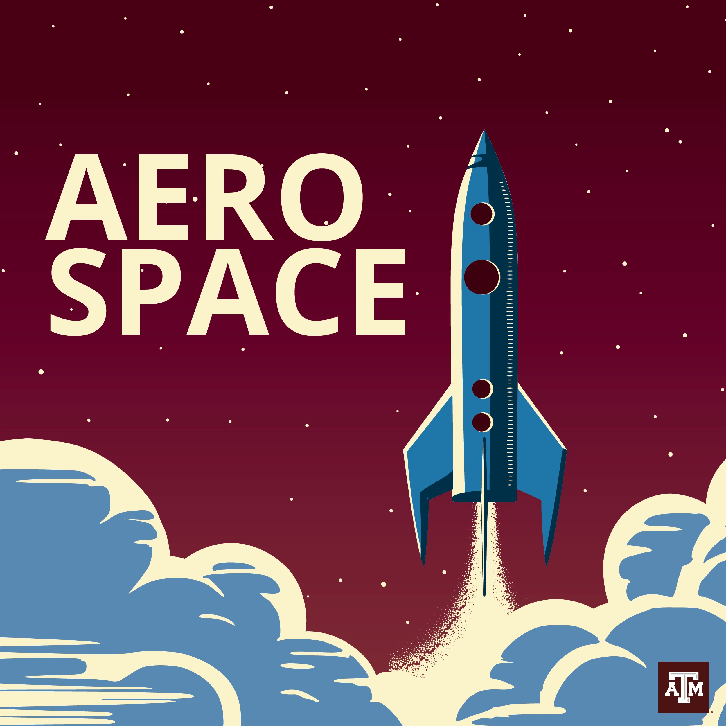

Illustrator is butchering the colors when I export.
I'm trying to get high-quality exports of some illustrations I'm working on, but when I export it messes all the colors up. I've attached both a screenshot (shows accurate colors) and an exported jpg (absolutely wrong) for two separate files. Can anyone tell me what I might be doing wrong? I didn't change any color settings or mess with any export stuff, and it's just WRONG. It's driving me nuts and no one else seems to be having this problem.

Jul 31, 2024 7:13 PM UTC
How do you export?
Your exported jpeg is missing a CMYK profile.
