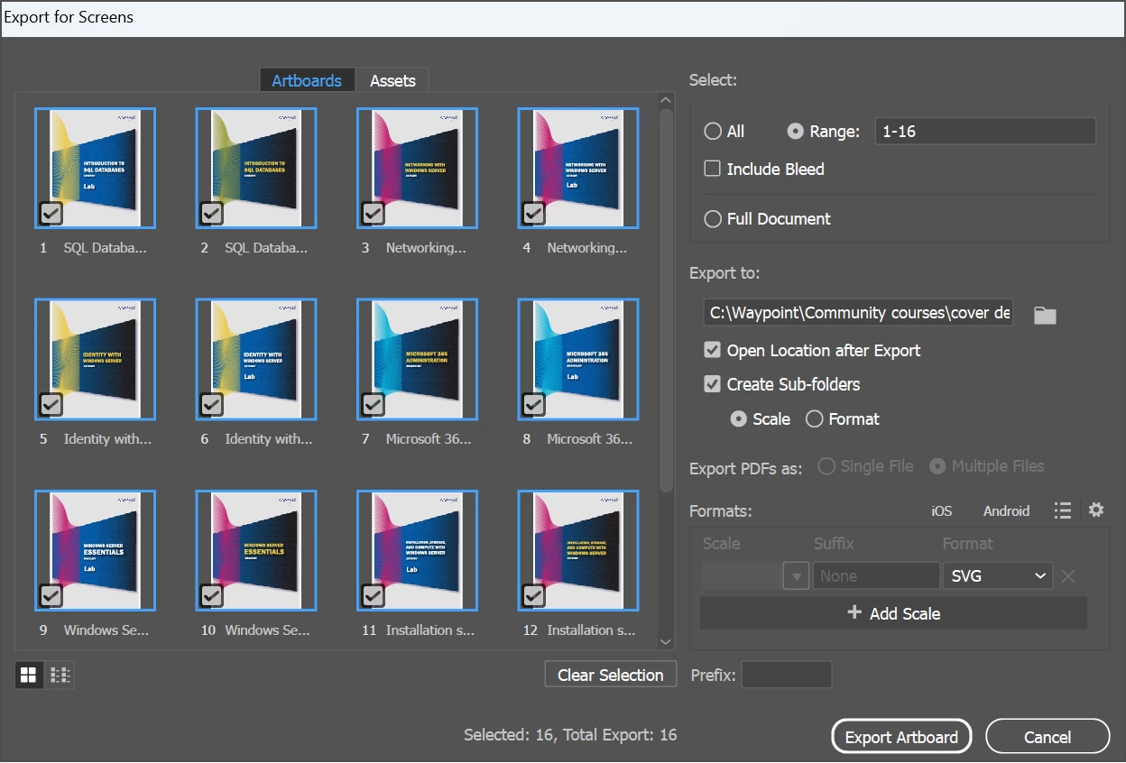

Hi. I'm using the latest updated Illustrator. I have a file with 16+ similar artboards. I'm exporting to SVG and PNG. The PNGs look fine but the SVGs are showing content that is not on the artboard I'm exporting--it's one of the ones that's beside it (I assume). I'm exporting by going to Export > Export for screens. I have also tried Export As (which had its own problems) and someone on the internet suggested using the legacy export but there's no SVG option. The only other thing I can think to do is make 16 files and export one by one but I really don't want to.

And also how your Export for screens is set up.

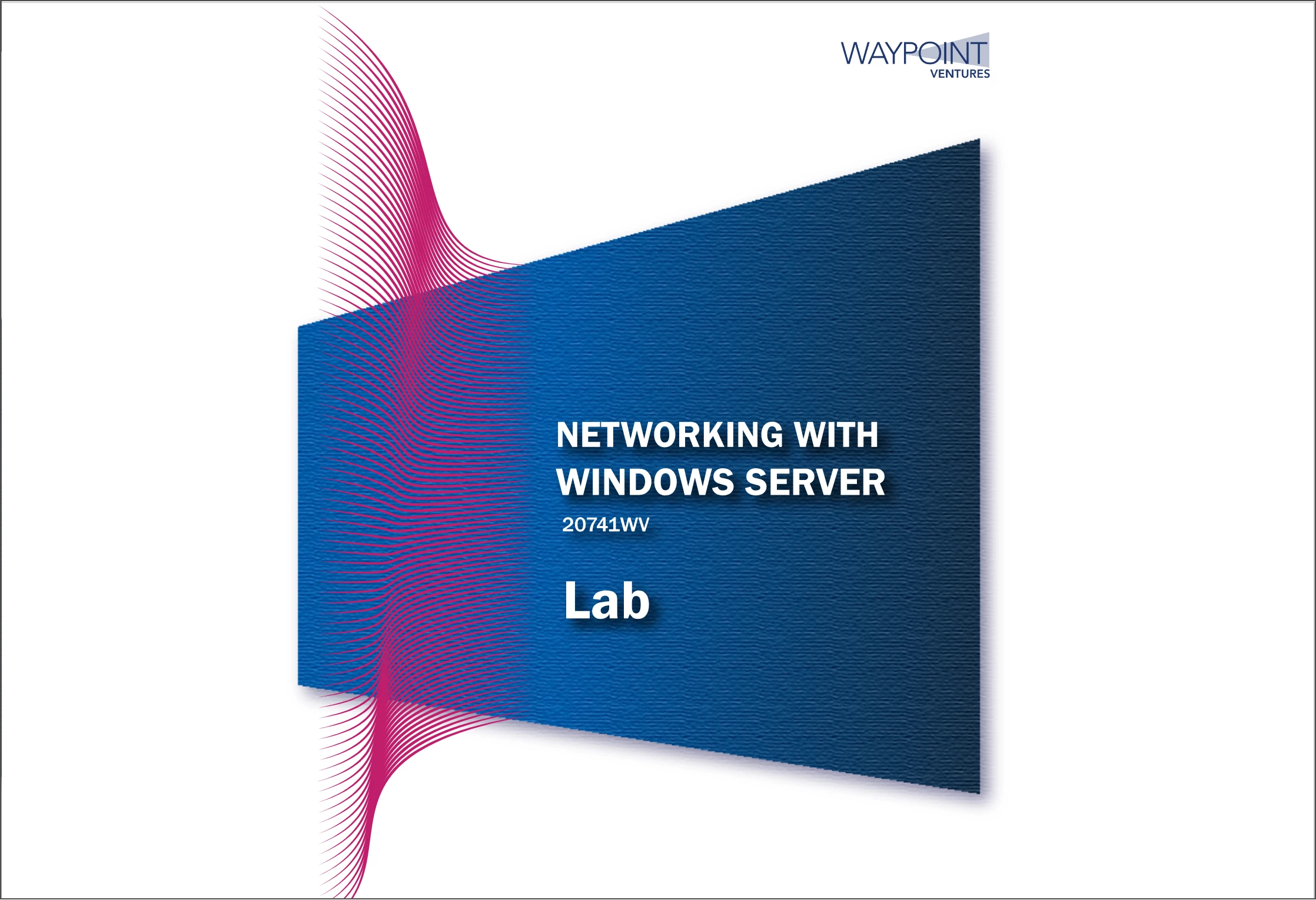

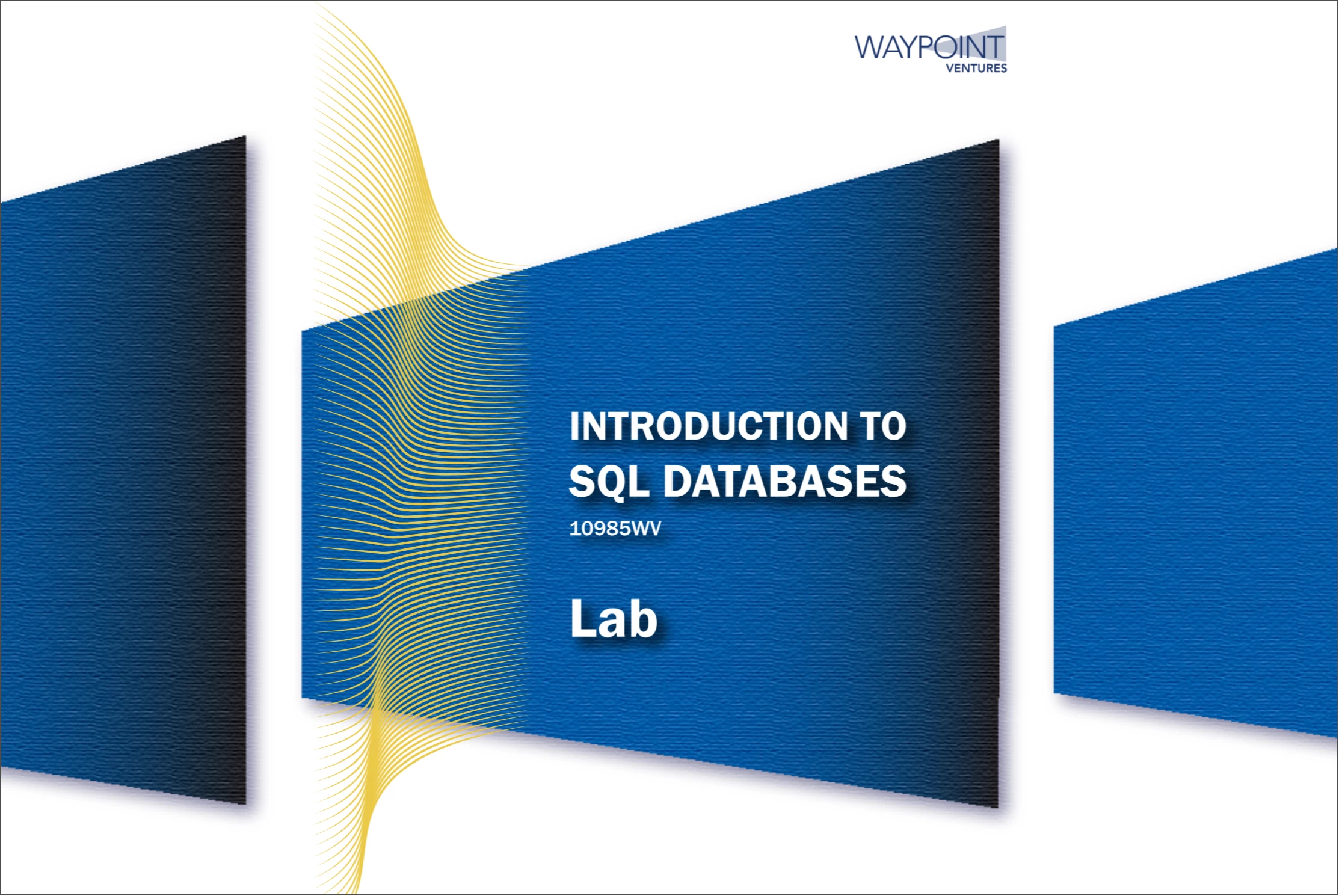

Here's a screenshot of my export plus a bad export and a basically correct one (all from the same export setup and file). The one I say is "basically correct" should be cropped all the way to the artboard. In terms of how I'm opening them, I'm generally viewing in Edge but I also tried dragging one into Illustrator to make sure I was seeing correctly. I have tried using asset export and at this point that's basically working but some items want to group that I am not intending to group. I wonder if that's part of the issue. If something outside the artboard is grouped with something inside the artboard but I certainly didn't mean for that to happen and don't want it to happen (I used alt to copy the backgrounds from artboard to artboard or I copied the artboard itself).

Where is the artboard here?
Are these artboards maybe too close to neighbouring objects?
Is there no clipping path in the SVG?
How is this built?
