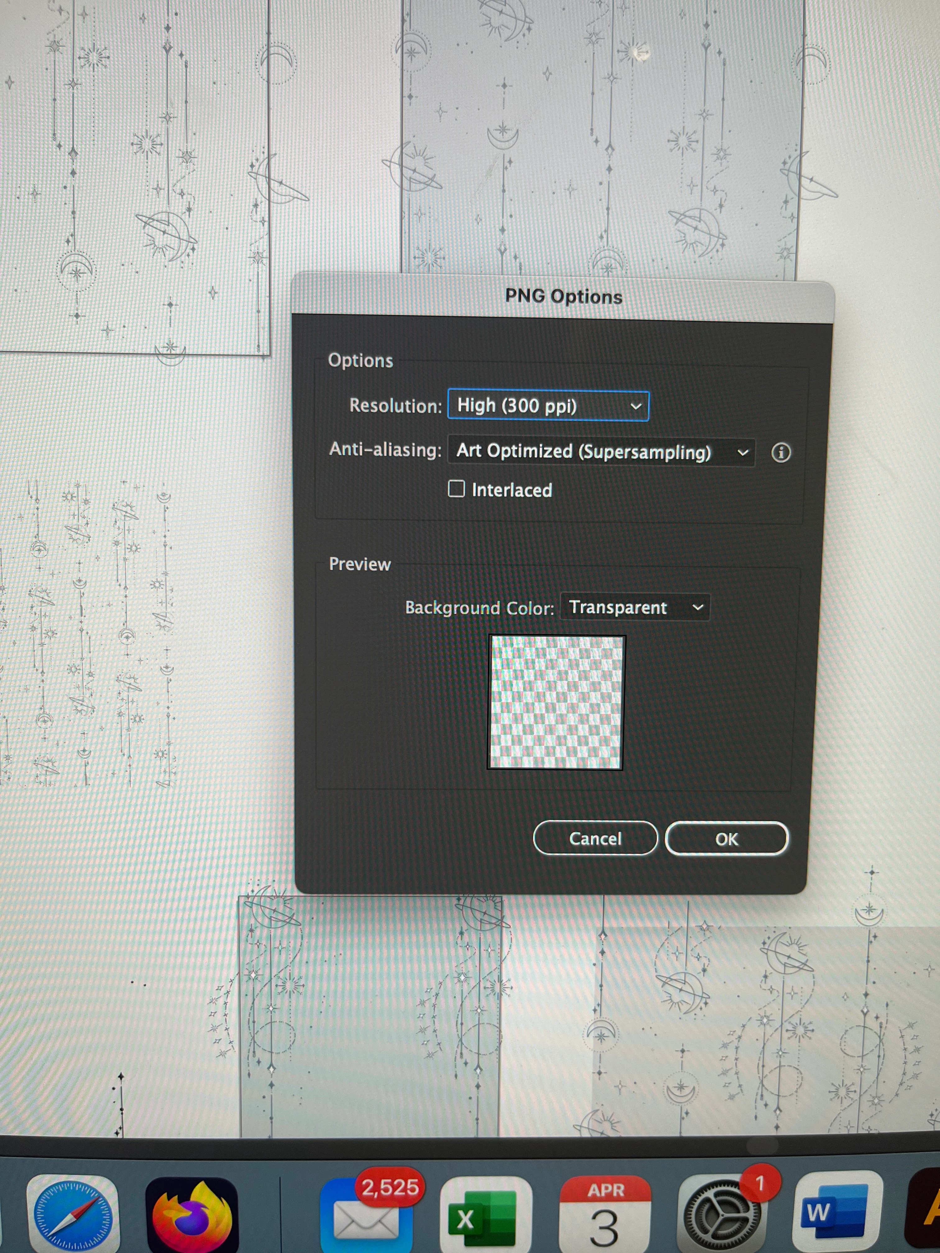

Hello! I'm having the same issue. When I go to File --> export as--> select the artboard I want to export as PNG, it shows a transparent blank artboard on the next screen. Do you know why this is? I updated my Adobe Illustrator as well and that didnt help. It only works if I do export for screens which I hate because it sends your files to another folder each time and sometimes the images are not as clear and high quality. I used your recommendation of unchecking overprint preview and that didnt help. Any other ideas please? I'm working on a large project and I need to figure this out ASAP!

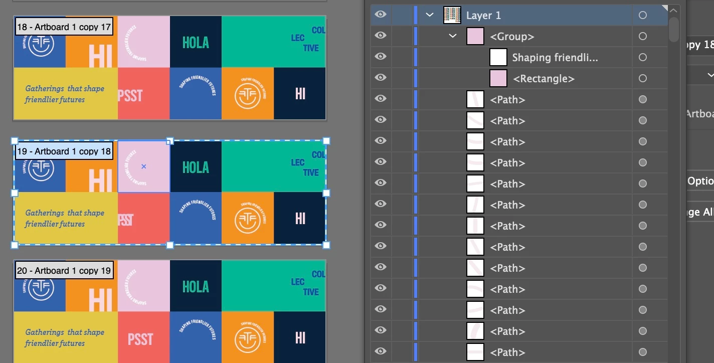

Please show something.
Contents of the layers panel are important as well. Perhaps the layers are set to non-printing?
June 15, 2021
Thanks Monika 🙂
I have not modified any layer preferences.

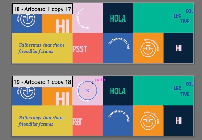

Below are two exported artboards. 19 is a  drag + duplicate of 18. You can see that all the artwork is visible on all of the artboard.s (1819.jpg) but when exported to jpeg, random items go missing. I literally selected the artboard tool to duplicate the previous artboard. This happens sucessfully. I modified some text, which exported correctly.
Here is a shot of the layer. Everything is visbible- which I would expect because this is all one layer, and the subgroups have not been modified. Its just these few artboards where content disappears. My export method was "export to jepg" artboards selected.
