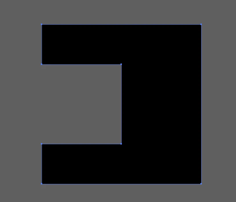

It is possible to count area with 5 mm. offset?
Example:
  I use this script and want to add a 5 mm offset in the count:
alert (app.activeDocument.selection[0].area);
I want to count irregular square where shape like U form, + offset. Shape 10x10 cm size, with 5x5 cm cut. I want to get a shape area not 75 cm2 but 101cm2.
It is even possible or not?

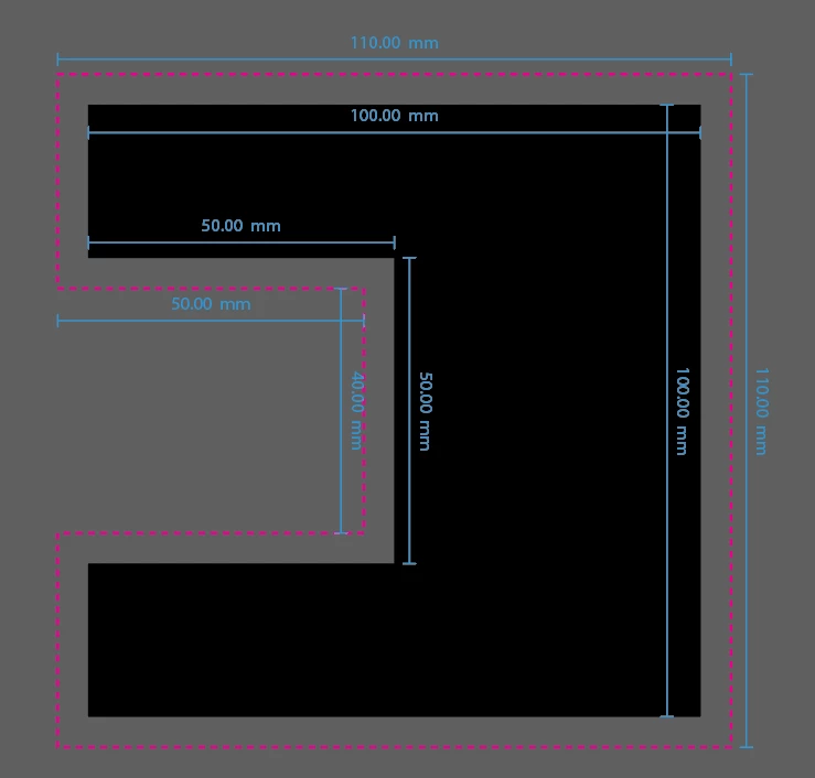

Everything that you all say is correct.
My issue is when, I have shape 100x100 mm with 50x50 cut, and that shape area is 7500 mm2.
Everything is ok if I count with this:
app.activeDocument.pathItems[index].area
 But I need that, area script count with like compensation. Count not original area but bigger shape like that(red dash line):
And then I get that my area is 10100 mm2. I Dont want to add that new one shape just for the count area, it is possible to make with the script?
femkeblanco
Nov 4, 2020 9:55 AM UTC
It's possible.  But why not simply do "offset path", run your line of code and then undo.  It will take seconds.  Scripting will just emulate this.
GalajasAuthor
Nov 4, 2020 11:41 AM UTC
Maybe it's possible, but I need in the same script real area and with „Offset path“, and I have countless different shapes where I mus count that area. That's why I ask it is possible to make that script, and maybe someone knows how?
