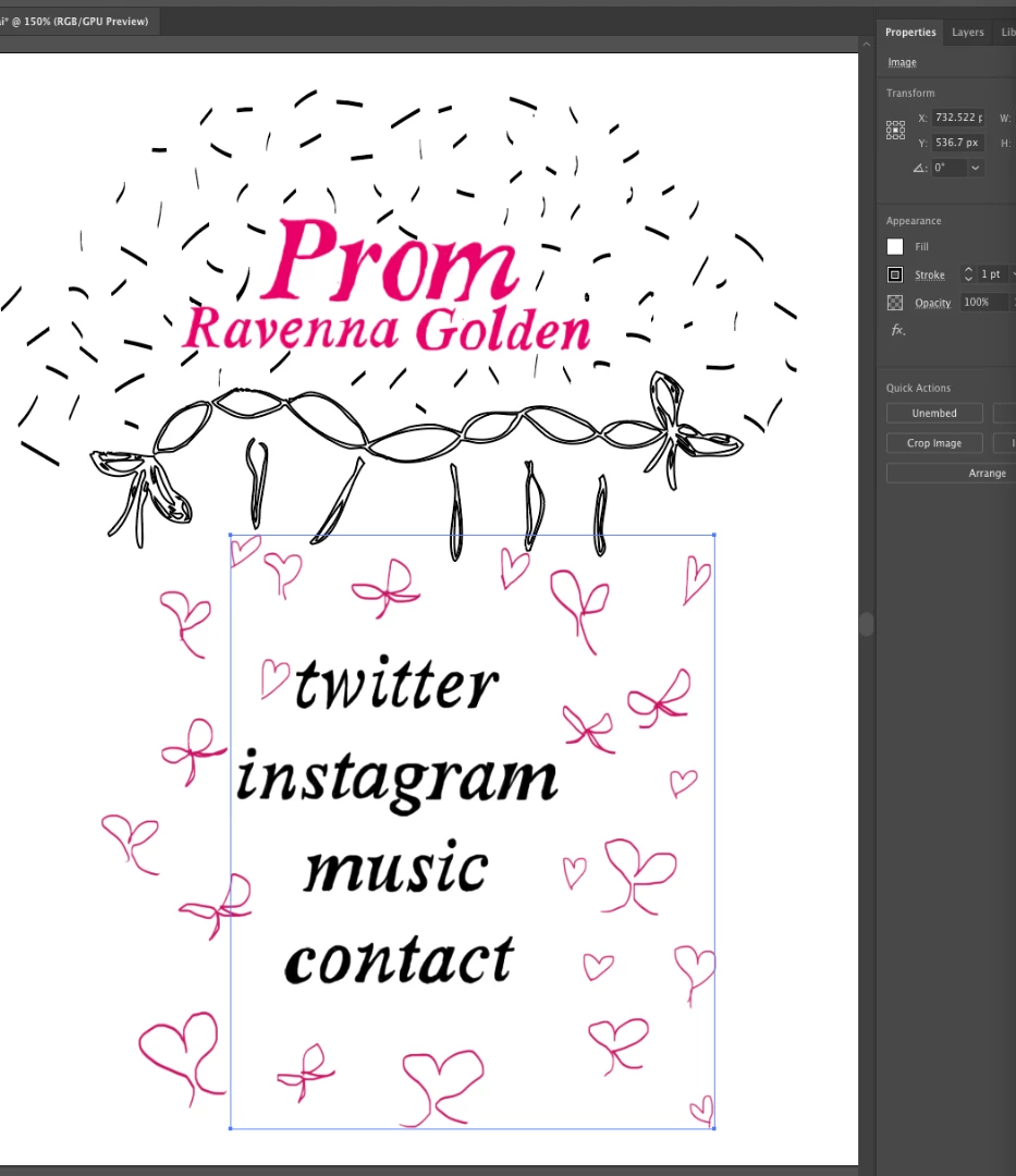

In the Properties panel it says image! When the other layers are showing up as "anchor points". Why is this happening? Including some photos here:
That's what shows when I click on ANY of the hearts to the right... It's obviously one large 'selection'(Im from Photoshop & awful at Illustrator). Also notice that it says Image in the properties pane.

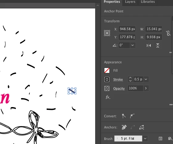

Here's what the other stuff shows when I click on it, which would be much nicer & the end goal here because I can save each and every one of these little pieces as separate SVG "assets" when using the export pane:
I made the image much smaller but you can see it also shows up as an Anchor Point here but it does not if I try to click the hearts.
So I'm guessing what's happening here is that this AI file was made with an image dropped into it rather than kept as anchor points(?) is there any way for me to just cut these out, so that I could set each one to a different layer(and therefore have it save as a separate SVG asset)? It doesn't even have to be a super clean selection because the background is just transparent, so if I could just draw even a square around these that would suffice.

Well, now you know what you are working with! It's possible they used Photoshop to create the hearts. When you zoom in, do you see pixels? If yes, it's raster.
If you look at it in Outline View (View menu), you will see a rectangle for an image.
  • You could use Image Trace to try to trace them into paths, which may or may not work.
  • You could put them on a locked layer and draw with the Pen (or Pencil) tool on top of them to get new paths.
  • You could work on it in Photoshop, but I think SVG wants vector.
Does it have to be identical to the original? If not, you can just draw them freeform and even copy some, then rotate, scale, and flip to make them look different. It looks like the hearts were drawn freeform originally.
In the control panel, does it tell you the name of the image?
