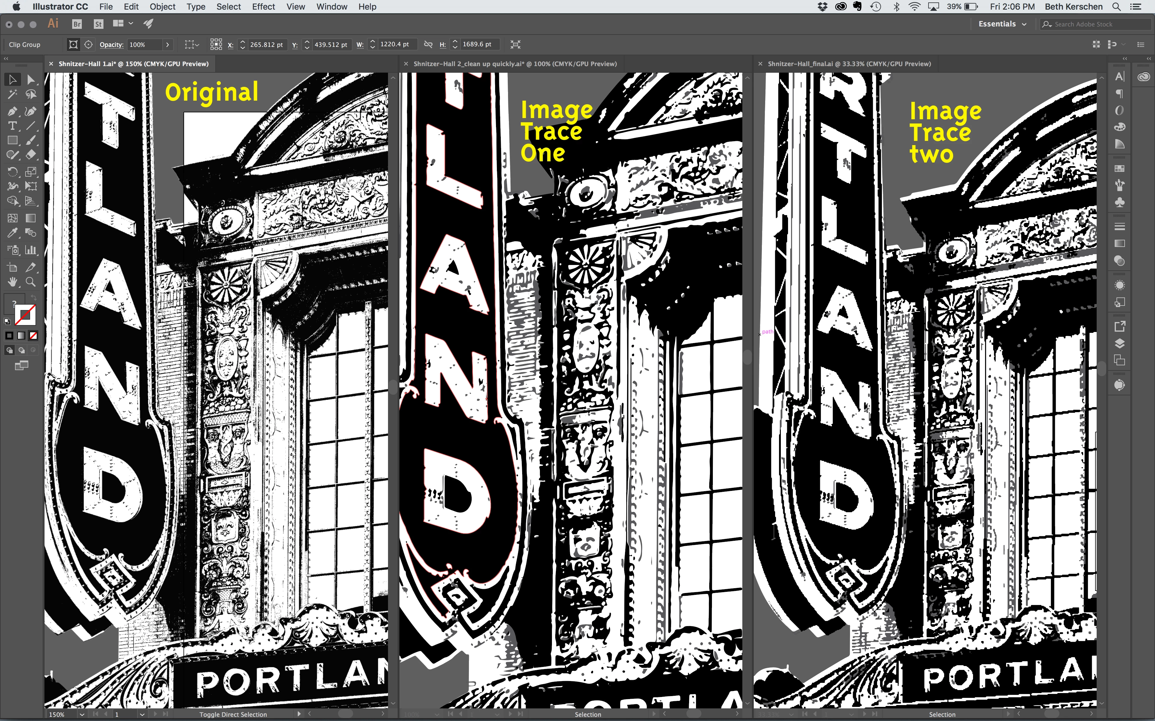

I have the same problem. See my attached image. I got it to work the first time when I made some line art with Image Trace, but not the second time or any subsequent times - using the same original. I tried starting with different resolutions of the original image. I also adjusted the path fitting and it didn't give enough detail like the middle one. It was like I got it to work once, but never again.

For Illustrator a pixel image is a pile of pixels. Tracing it exactly would mean to trace each and every pixel. But that won't give smooth paths, so you think it's ugly. Illustrator knows nothing about what you like. It only knows what is exact.
On top of that there are real issues with black and white images. Image trace is just not made for that type of black and white detailed images.
